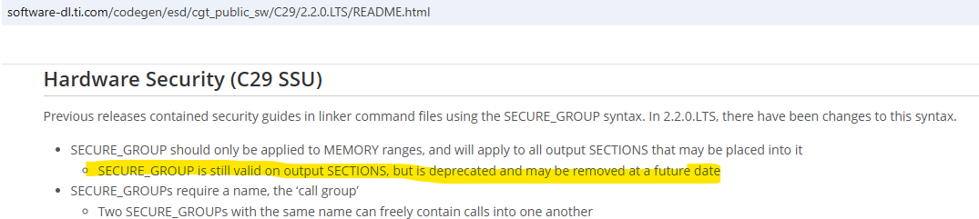

In the documentation of the clang for the F29, it is indicated that SECURE_GROUP can be used on output sections but now how and I found in the online documentation that the support of SECURE_GROUP on output sections is deprecated and could be removed in the future which would be problematic for us.

  • Hi Ronan,
    Security being applied at the output section level was deprecated because it did not fit the level of abstraction on which security acts.
    Output sections represent software. Data and code which comprise the application.
    Memory regions represent hardware. Distinct pieces of real device memory into which output sections are placed before being loaded and executed on the device.
    Security subsystems are hardware features. Syscfg splits physical memory regions available on the device and assigns each to a secure region of code/memory. Because of this, we identified that output sections were not the correct abstraction, and moved the specification up to the memory regions.
    There are currently no plans to remove output section specification, but this deprecation warning exists to cover the possibility of future features which may not apply to the output section specification.
