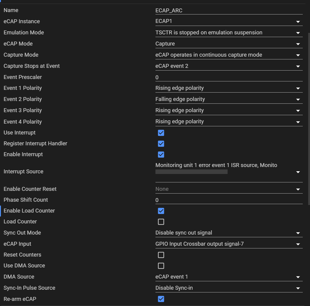

On the F28P65x eval board, I am trying to use an eCAP module to generate an interrupt when an external input signal has a positive pulse width greater than 100000 clock cycles. I used a function generator to inject a constant square wave on GPIO16. I saw that the eCAP module generated an interrupt, with the interrupt flag set to 1026 (0x402), after the code started. However, the interrupt fired only once with the constant-pulsed input. Is anything required to clear MUNIT_1_ERROR_EVT2 besides the interrupt flag? The following are my SysConfig settings for eCAP and the ISR code snippet.

    I experimented with the Emulation Mode setting during my early tests. It didn't seem to help. I just confirmed again that setting it to "TSCTR is not affected by emulation suspension" has no effect on the outcome. The following are my updated Sysconfig settings.
    It is a good idea to generate the error as soon as the pulse width exceeds the limit. I had a line in the code to set the early max error check right after the board initialization, "ECAP_setupEarlyMaxErrorCheck(ECAP_ARC_BASE, ECAP_MONITORING_UNIT_1, ECAP_PULSE_WIDTH_CROSS_MAX_VALUE);".

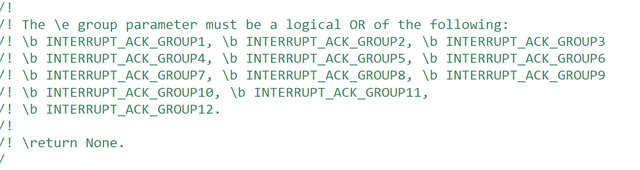

    Since interrupt is only generated once , there is something wrong in the interrupt configuration. At the end of the ISR, one needs to acknowledge the group interrupts for more interrupts to propagate. This is done by using function Interrupt_ClearACKGroup() in your code. I am not sure that your code is picking up correct group number (corresponding to the ECAP module you are using). Kindly check group number from table 3-2 given on page 144 of Technical Reference Manual.  Here, group number is represented by row.
    Based on the group number, you can choose enumerator ( INTERRUPT_ACK_GROUPx where x=group number corresponding to ecap module being used).
    Also, there is no example other than named as "ecap_ex5_signal_monitor" which will emulate your test scenario.
    Divesh
    Please try using Interrupt_clearACKGroup(INTERRUPT_ACK_GROUP4) instead of the one used by you. Please note that group number for ECAPx module is 4.
    Divesh

    I am currently using the define "INT_ECAP_ARC_INTERRUPT_ACK_GROUP" from board.h to acknowledge the group interrupt. I also confirmed that "INT_ECAP_ARC_INTERRUPT_ACK_GROUP" is set to "INTERRUPT_ACK_GROUP4" in the header file. Please see below.

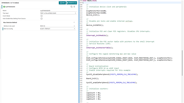

    I imported the TI project "ecap_ex5_signal_monitor" into CCS and made a single correction to the sample code to initialize the global variables, as shown below.
    This TI sample program exhibits the same behaviour I observed in my own code. The ERROR_EVT1 interrupt triggers only once. I don't know whether you have an eval board for F28P65X. If you do, could you please confirm whether you see the same behaviour on your setup?

    In the example, munit1_evt1 error generates a trip signal for EPWM1 module. Hence, the same was confirmed by probing the signal after running the example. This was done by disconnecting jumper from GPIO0 to GPIO16 and probing GPIO0 signal (eEPWM1_A).  The trip 1 signal is routed to EPWM digital compare module through EPWMXBAR. Please note source of trip 1 signal is ECAP1_TRIPOUT.
    This is the reason why we are not observing monitoring unit interrupt again. Please reach out if there is query.
    Divesh
  • Hi Divesh,
    Thank you for the information! The eCAP interrupt is triggered back-to-back after removing the EPWMXBAR.
