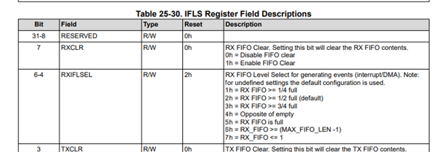

Customer uses SPI for SoC and MCU communication, when the SPI Interrupt is triggerd, the ISR read out all the data in SPI FIFO and ack. when customer using FIFO is ½ full interrupt, the interrupt can be triggerd and ISR run properly, but when customer using FIFO is at least 1/16 full - "not empty", the interrupt trigger Freq is less than expectation and data cannot be properly read out by ISR. I would like to  understand how "not empty" triggered with this SPI design and how to use it properly?

    I'm assuming you are talking about the RX FIFO? If so, is data being sent by the transmitting device at the same rate for both cases?
    Which value of RXIFLSEL is being set in each case exactly?

    value of RXIFLSEL :customer used sysconfig to configure the SPI RX FIFO level, for 2 different cases:
    FIFO is ½ full:
    DL_SPI_setFIFOThreshold(APP_SPI_CONTROLLER_INST, DL_SPI_RX_FIFO_LEVEL_1_2_FULL, DL_SPI_TX_FIFO_LEVEL_1_2_EMPTY);
    I jump into the drivelib file, the DL_SPI_RX_FIFO_LEVEL_1_2_FULL value is  0x00000020U
    FIFO is at least 1/16 full - "not empty":
     DL_SPI_setFIFOThreshold(APP_SPI_CONTROLLER_INST, DL_SPI_RX_FIFO_LEVEL_NOT_EMPTY, DL_SPI_TX_FIFO_LEVEL_1_2_EMPTY);
    I jump into the drivelib file, the DL_SPI_RX_FIFO_LEVEL_NOT_EMPTY value is  0x00000040U
    One thing confusing me is that if I assume not empty should be triggered when there is the data in FIFO, looks like the interrupt will not be able to be cleared once the RX FIFO has some data in it, and in customer test the interrupt also cannot run normally.

    I ran some tests myself with the RX FIFO "not empty" interrupt setting. My test transmits10 data bytes and reads one received byte at a time. I see that the ISR is triggered 10 times and all data is received correctly.
    How many bytes is the customer reading inside their ISR?
