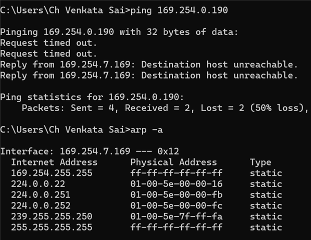

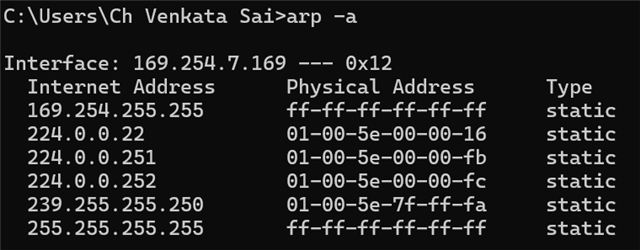

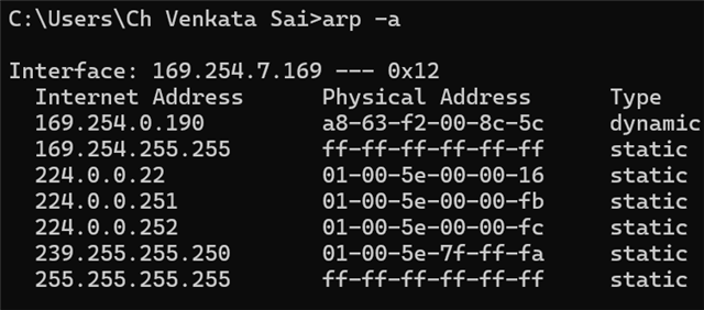

I am running the enet_lwip example code on the TMDSCNCD28388D using C2000Ware_6_00_01_00. The example works properly with the default dynamic IP / MAC settings, but stops working after I change the IP address and MAC address.
OBSERVED:
C:\Users\gpc3>ping 192.168.1.190
Pinging 192.168.1.190 with 32 bytes of data:
Reply from 192.168.1.53: Destination host unreachable.
Ping statistics for 192.168.1.190:
    Packets: Sent = 4, Received = 4, Lost = 0 (0% loss),

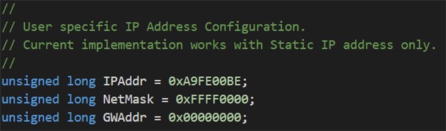

    // User specific IP Address Configuration.
    // Current implementation works with Static IP address only.
    unsigned long IPAddr = 0xC0A801BE;
    unsigned long NetMask = 0xFFFFFF00;
    unsigned long GWAddr = 0x00000000;

  • Wireshark or tshark is not installed on my PC. There are other PCs connected to the same Ethernet switch. I also tried a direct connection using a single Ethernet cable from the TMDSCNCD28388D to my PC, but I am still experiencing the exact same issue
    I established a direct connection using a single Ethernet cable from the TMDSCNCD28388D to my PC. Based on the device configuration, I updated the IP address to 169.254.0.190 and the MAC address to A8-63-F2-00-8C-5C. After calling lwIPStart(), I checked the ARP table using the Windows Command Prompt.
    Whenever checking the ping test 169.254.0.190 I am getting like this
    Again i am checked the arp table when the interface connection is missing

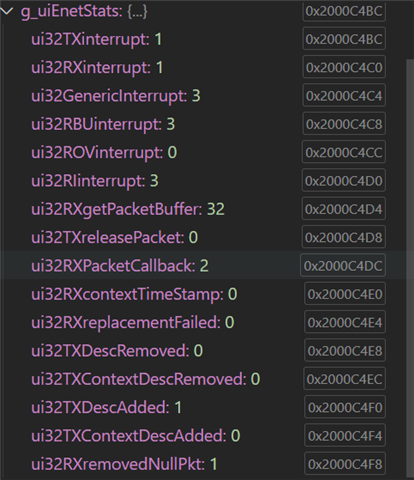

    Also can you build the binary with ETHERNET_DEBUG defined and share the content of structure 'g_uiEnetStats'.
    Content of g_uiEnetStats
  • Hi ,
    Can I know the rate at which you are trying to send packets to the board?

    Hi Can you try this binary and check whether this is working for you?
    IP Address - 169.254.0.190
    Subnet Mask - 255.255.0.0
    MAC address - A8-63-F2-00-8C-5C
    I tried using the code modifications, but I am facing the same issue. After lwIPStart(), the interface connection appears in the ARP table, but the green LED does not blink
    Furthermore, when I attempt a ping test, the connection drops entirely.
