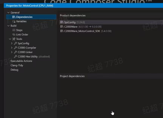

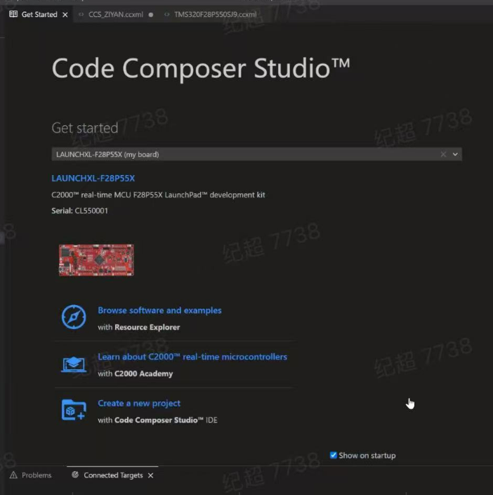

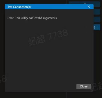

Customer reports an issue that with the correct ccxml, the CCS cannot invoke the XDS110 debug probe properly, the XDS110 debug probe can be correct recognized by PC and CCS start page, pictures are below, do you have any suggestions on this issue?
besides the pictures below, I also checked:
  • Windows device management can recoginize XDS110
  • XDSDFU can properly involked and update XDS110 FW
  • CCXML file configuration works well in other computers
