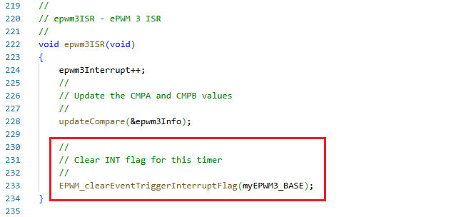

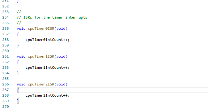

F29H859TU-Q1: Why it isn't clear interrupt flag in timer interrupt?
Part Number: F29H859TU-Q1
Hi team,
I ask this for my customer.

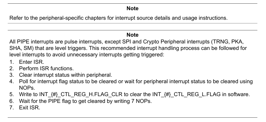

In our TRM, it says the recommended interrupt handling process, and shows it should clear the interrupt flag before it returns from the ISR
And in our PWM, ADC and other peripheral interrupt demo, it should clear INT flag before it exits the ISR
but it isn't clear the timer interrupt flag
could you help to explain it? thanks
BRs
Shuqing

  • Hi Zackary,
    Could you help to point out where have the statement you mentioned in TRM?
    BRs
    Shuqing
  • Hi Shuqing,
    The relevant TRM statement is found in the TCR (Timer Control Register) field descriptions for the CPU Timer module. Specifically, the TIF (Timer Overflow Flag) bit description in Table 2-578 of the F29H85x TRM states:
    "TIF is not cleared automatically and does not need to be cleared to enable the next timer interrupt." [1]
    Correction to the Previous Response
    I need to clarify something important from the previous reply. The TRM does not describe a "hardware auto-clear" mechanism in the way it was stated. Rather, the actual behavior documented in the TRM is:
    Aspect
    What the TRM Says
    Auto-clear?
    No — "TIF is not cleared automatically" [1]
    Required for next interrupt?
    No — "does not need to be cleared to enable the next timer interrupt" [1]
    How to clear manually
    Write a 1 to the TIF bit (R/W1C type) [1]
    So the reason the timer demo code doesn't clear the interrupt flag is not because it auto-clears, but because clearing it is simply not required for the timer to generate subsequent interrupts. The flag is a status indicator that persists until you explicitly clear it, but unlike PWM/ADC flags, leaving it set does not block future timer interrupts [1].
    This is the key hardware design difference: for peripherals like ePWM and ADC, the interrupt flag must be cleared or the peripheral will not generate another interrupt. For the CPU Timer, the interrupt mechanism operates independently of the TIF flag status.
    TRM Location
    You can find this in the CPU Timer chapter, specifically:
    • Table 2-578: TCR Register Field Descriptions — Bit 15 (TIF) [1]
    • Page 899 of the F29H85x TRM (spruj79a)
    The DriverLib function CPUTimer_clearOverflowFlag() is available if the customer wants to clear TIF for status-tracking purposes, but it is functionally optional for interrupt generation.
