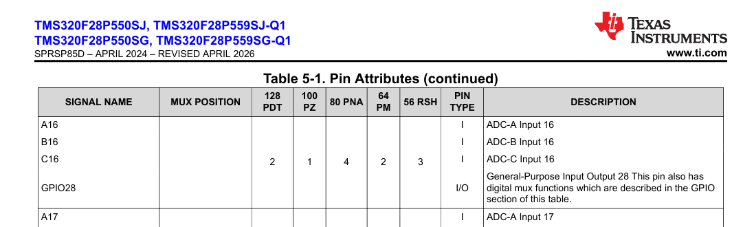

May I ask about below multiplexed pin? Can I use A and B to read the register at the same time?
BRs,
Rannie

    Short Answer: No, you cannot use both A16 and B16 simultaneously on the same physical pin.
    Explanation:
    Looking at the pin attributes table you've shared, A16, B16, and C16 are all multiplexed to the same physical pin (GPIO28). This means:
    1. Only ONE function can be active at a time on this physical pin
    2. The MUX POSITION setting determines which function is currently active:
      • If you configure it as A16 (ADC-A Input 16), only ADC-A can read from this pin
      • If you configure it as B16 (ADC-B Input 16), only ADC-B can read from this pin
      • If you configure it as C16 (ADC-C Input 16), only ADC-C can read from this pin
      • You can also configure it as GPIO28 for general-purpose I/O
    3. The pin mux configuration is controlled by registers (typically GPxGMUX and GPxMUX registers) which select one of the available functions
    What You CAN Do:
    If you need to read the same analog signal with both ADC-A and ADC-B:
    • Route the external signal to two separate pins - one configured as A16 and another configured as B16 (on different physical pins)
    • This allows simultaneous sampling by both ADCs
    Register Configuration:
    The pin function is selected through the GPIO mux registers, and only one configuration can be active. You cannot have multiple ADC inputs reading the same physical pin simultaneously.
