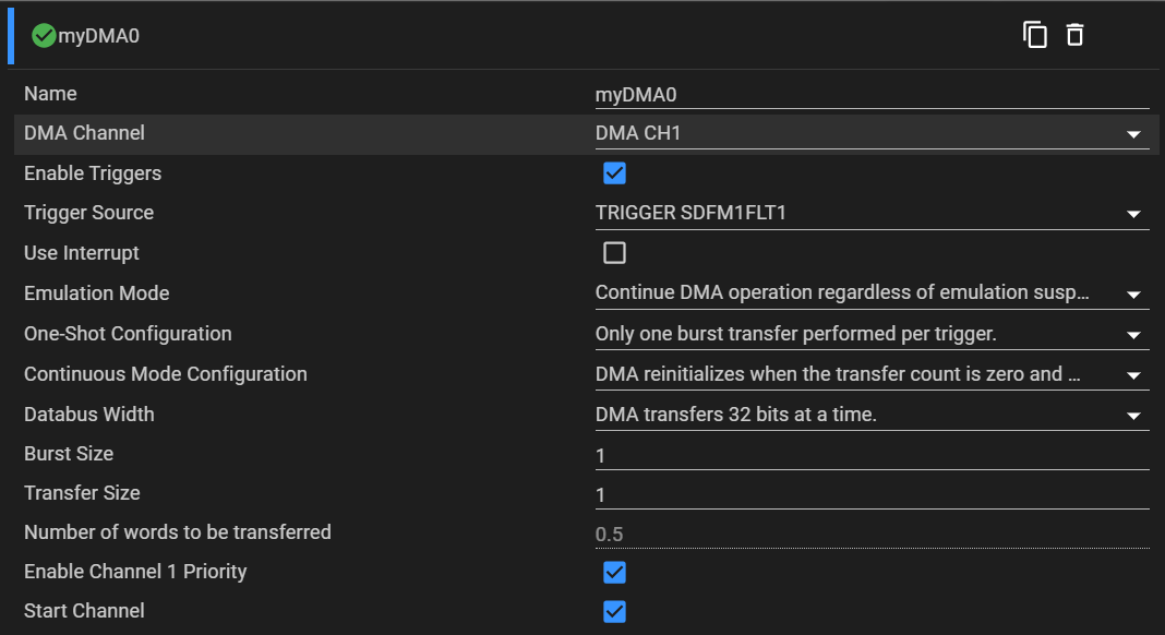

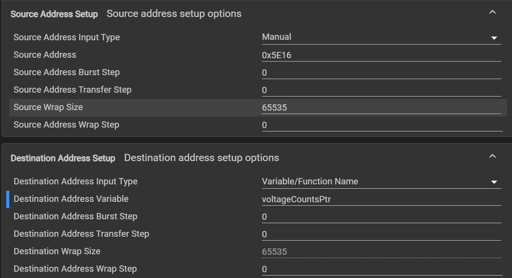

I have a functioning SDFM module which is receiving a voltage and outputting a value. I want to send this value to a variable I have defined in my program using the DMA

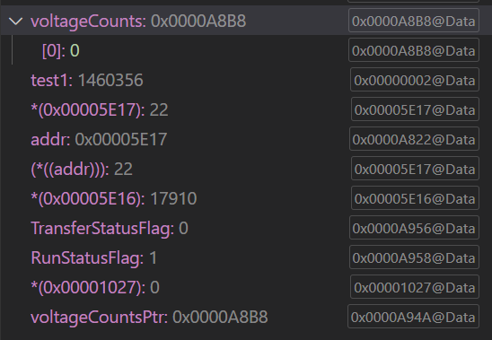

See below, the value from SDFM is currently being stored in test1 (in the mainloop of the program). That value is being held in ((int32_t *)(SDFM1_BASE + SDFM_O_SDDATA1 + 1)) which corresponds to the 32-bit value in 0x5E16 and 0x5E17.
But this value is not being transferred to the variable I have designated. I am unsure if my DMA settings are incorrect or if this issue lies elsewhere.
See DMA setting below:

Can TI confirm if the DMA settings are setup to achieve the desired affect?

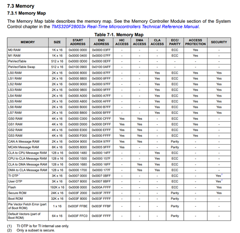

    My apologies for the delay. I think I see your issue. The voltageCounts variable is being placed at address 0xA8B8, which is LSRAM5 on this device.
    The DMA only has access to GSRAM memories. Can you add the below line of code to designate to the compiler that you want to place the voltageCounts variable in GSRAM0?
    #pragma DATA_SECTION(voltageCounts, "ramgs0");
    Depending on the linker cmd file you are using, you may have to add the below line to that file in SECTIONS{} to create the ramgs0 user defined section.
       ramgs0 : > RAMGS0, type=NOINIT
    Delaney
