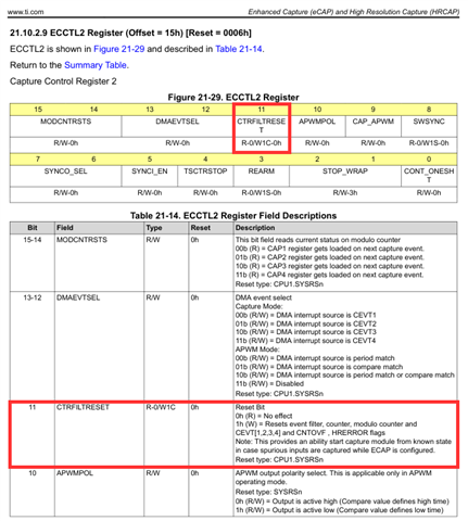

hi, experts!
may you have a nice day!
In the description of the ECCTL2 register table for eCAP, writing 1 to the CTRFILTRESET bit can clear the HRERROR flag. However, I did not find this bit in the TRM document. Could you please tell me what this bit is?
Looking forward to your reply.
Best regards!

  • Thank you for your response, but you misunderstood the question. I would like to know what the "HRERROR" flag means and where it is documented.
  • Hi Chsang,
    Apologies for the misunderstanding here.
    This is a documentation issue in the chapter, and I will file an internal ticket to track the update efforts.
    HRERROR is actually an ECAP interrupt option used for internal testing that should not be included in this register description.
    Raw Description:
    HRERROR is set if pulse width of input signals is detected to be < 3*HRCLK cycles. Due to synchronizer uncertainty, it is not possible to measure pulse width accurately. This logic does work of all cases, for example input pulse less than a cycle may not event get detected by synchronizer, a pulse width 2*HRCLK cycles may be seen as 3*HRCLK cycle on synchronizer output hence may go undetected. This logic is not reliable but may be useful for internal testing.
    Please do not worry about this flag for your usage. The actual interrupt option is correctly removed from the registers, which is why you don't find it anywhere.
