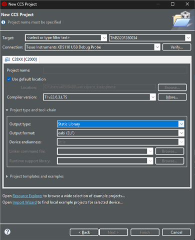

  • Hi Wayne,
    Apologies for the delay. The steps for creating a static library for the CLA are below:
    1. Add new .h and .cla files into your project that will make up the library content, for example my_lib.h and my_lib.cla
    2. Inside the .cla file, have a #include "my_lib.h"
    3. Inside the .h file, add guardrails so that the file is only compiled for the CLA
      #ifdef __TMS320C28XX_CLA__ // only compile for the CLA
      // my_lib.h file content, usually externs for all the functions in my_lib.cla
      #endif
    4. Verify that this code works with your existing project by calling the functions from CLA tasks
    5. Create a new project in CCS and select the output type as "Static Library"
    6. Copy all .h and .cla files over to this secondary project. Right-click on the main.c file and click "Exclude from Build"
    7. Build the secondary project like normal
    8. Copy over the generated .lib file from the secondary project (usually output to Debug/my_lib.lib for example) into your original project
    9. Right-click on .h and .cla files from the original project and "Exclude from Build"
    10. Rebuild original project with .lib added in
    11. Test out project with static library added
    Let me know if they have any other questions and/or want me to share the example project(s) I made to try this out. They can verify after step 10 that the build is using the lib file by seeing if it is present in the .map output file.
