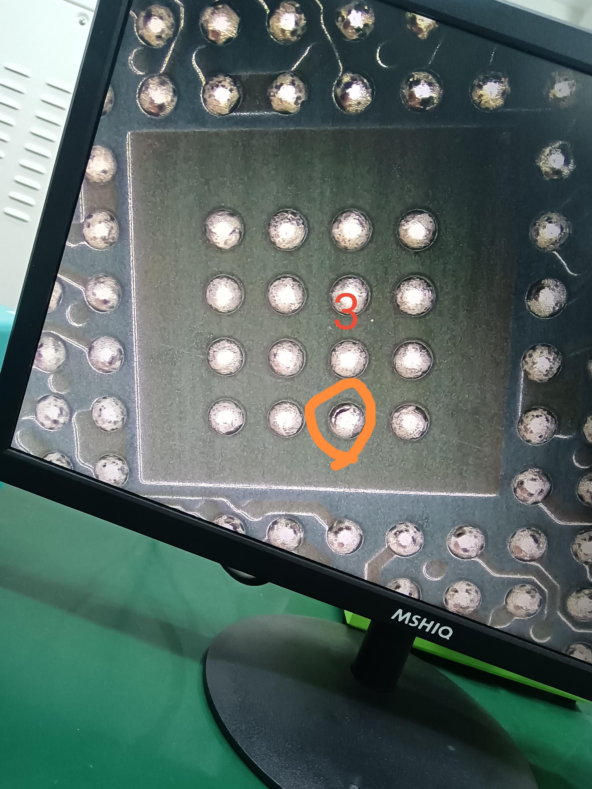

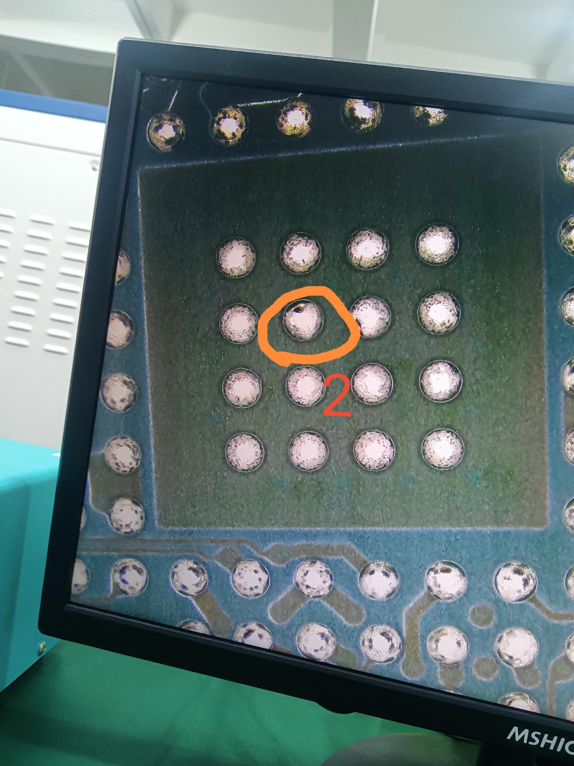

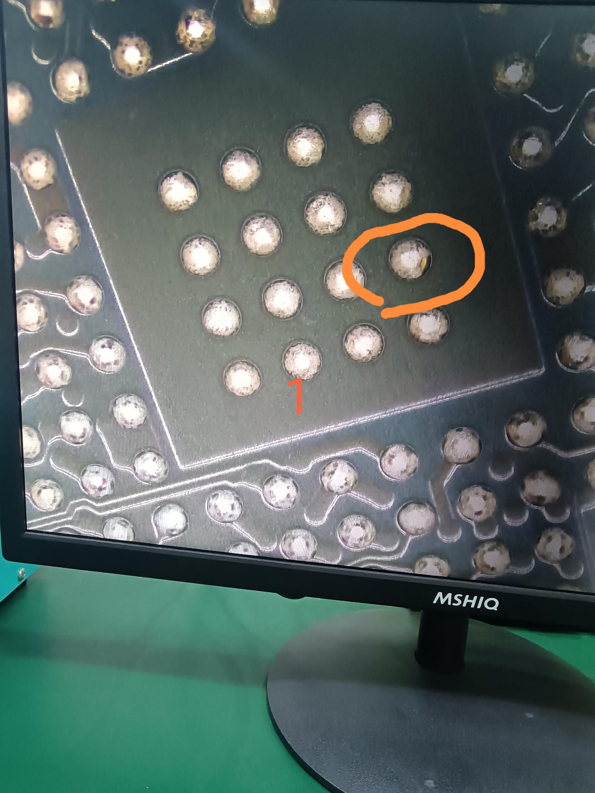

The TMS320F28335 chip solder ball has the following issues, resulting in virtual soldering during soldering. Please help to check if there are any changes to the welding process and conditions. It can avoid the problem of virtual soldering. Thanks.
  1. Some solder balls appear to be partially missing.image_1778678220979.jpgimage_1778678304381.jpgimage_1778678225208.jpgimage_1778678228562.jpg
2. The middle 16 pads are relatively smooth, while the surrounding pads are relatively rough.

    Thank you for reaching out regarding the TMS320F28335 solder ball issues. The problems you're describing — partially missing solder balls and inconsistent pad surface finish (smooth center pads vs. rough outer pads) — are concerning quality issues that can lead to poor solder joints and reliability problems.
    1. Check Device Quality & Handling
    • Inspect incoming parts: Verify that the solder balls are intact upon receipt and document any issues before assembly.
    • Storage conditions: Ensure proper moisture sensitivity level (MSL) handling. The TMS320F28335 should be stored and handled according to J-STD-020 standards .
    • Check for physical damage: Missing solder balls could indicate mechanical damage during shipping or handling.
    2. Pad Surface Finish Concerns
    The difference in pad surface finish (smooth center vs. rough outer pads) may suggest:
    • Possible oxidation on outer pads
    • Non-uniform solder mask application
    • PCB manufacturing quality issues
    • Different thermal exposure during previous processes
    3. Soldering Process Optimization
    For BGA packages like the TMS320F28335, consider the following process adjustments:
    Solder Paste Application:
    • Use Type 3 or Type 4 solder paste for better print definition
    • Ensure proper stencil thickness (typically 0.125 mm for BGA)
    • Verify paste volume is adequate but not excessive
    Reflow Profile:
    • Follow the temperature profile specified in the TMS320F28335 datasheet
    • Typical peak temperature: 235–245°C for SAC305 solder
    • Time above liquidus: 60–90 seconds
    • Ramp rates: 2–3°C/second
    PCB Pad Design:
    • Verify NSMD (Non-Solder Mask Defined) pad design
    • Pad diameter should be 80–90% of solder ball diameter
    • Ensure proper solder mask clearance
