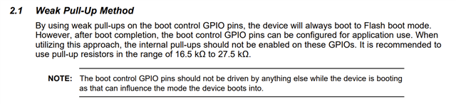

Additional information:
  • GPIO72 and GPIO84 are currently floating on custom board.
  • TRSTn is available.
  • LaunchPad works with same software.
  • CPU2 boot issue only occurs on custom hardware after POR.
Questions:
  1. Can floating GPIO72/GPIO84 affect CPU2 standalone FLASH boot reliability even if CPU1 boots correctly?
  2. Does CPU2 standalone boot depend indirectly on CPU1 boot-mode sampling/reset sequence?
  3. Are external pull-ups on GPIO72 and GPIO84 mandatory for reliable dual-core FLASH boot?
  4. Is there any recommended reset timing or CPU2 boot delay sequence for custom F28377D hardware?
  5. Is there any additional hardware requirement for standalone CPU2 FLASH boot on custom boards?
