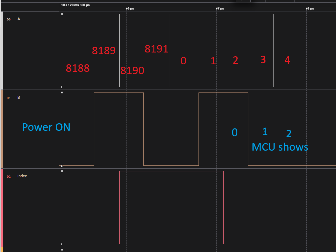

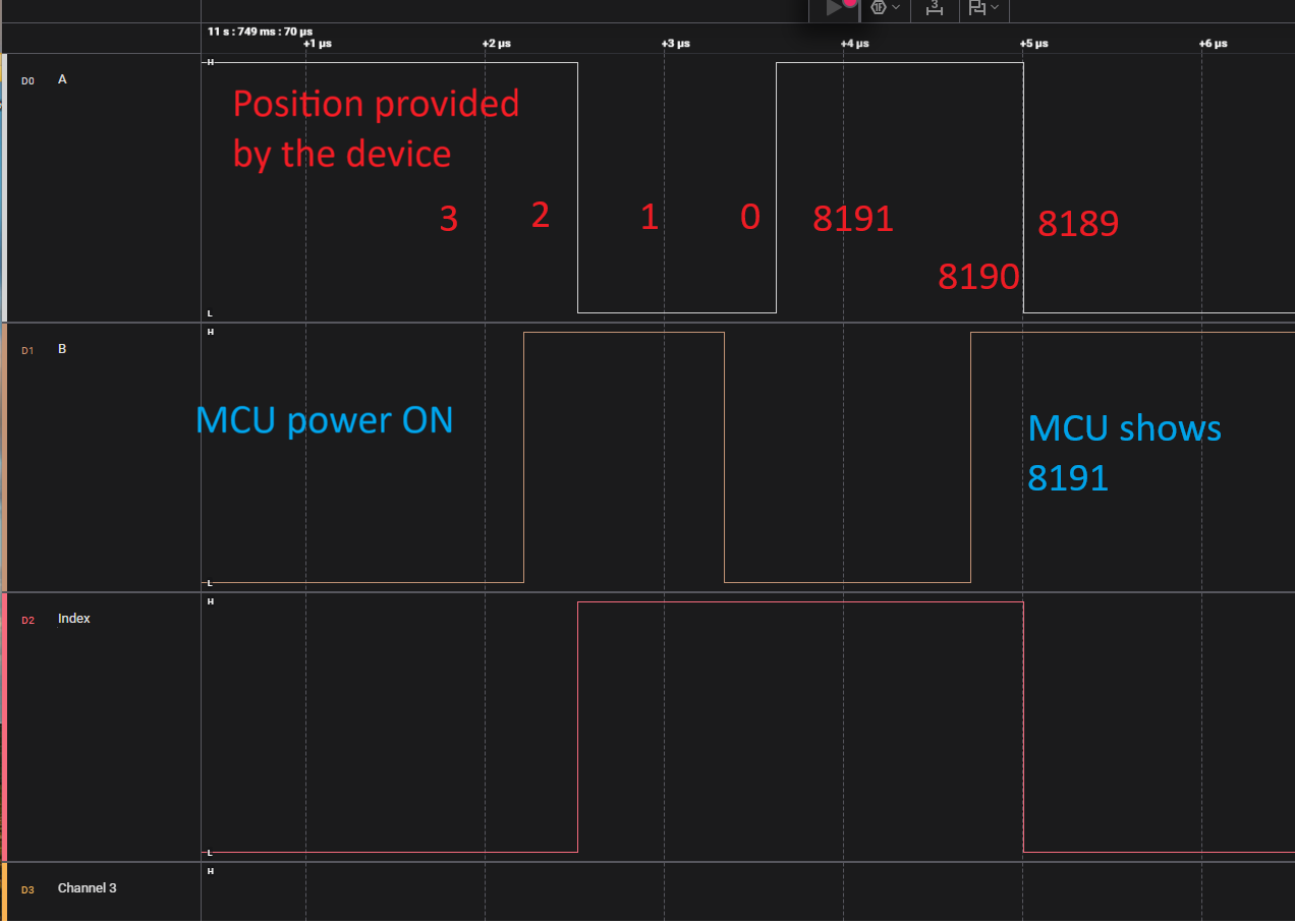

We are having device emulating ABI interface connected to MCU TMS320F28388D.
MCU is using eQEP module configured to measure position.
We have problems with eQEP module initialization by Index input. Position is initialized with offset and offset is dependent on direction of movement during first index signal occurrence. During next rotation, offset seems to be constant as was initially set.
Do you have any proposals on how to configure TMS320F28388D to operate without this offset? Or at least how to configure it so offset is not dependent on direction of first movement?
eQEP module is now configured as follows:
QDECCTL[XCR] = 1
QDECCTL[SWAP] = 1
QDECCTL[QIDIRE] = 1
QEPCTL[FREE_SOFT] = 2
QPOSMAX = 8,192
QEPCTL[QPEN] = 1
Remaining eQEP registers are set to default values.
In attached pictures are captured ABI wave forms for both directions of movement during first index occurrences.direction_2.pngdirection_1.png

    The behavior is consistent with the mode " POSITION COUNTER IS RESET ON FIRST INDEX". If the index event occurs during forward movement, then the position counter is reset to 0 on the next eQEP clock. If the index event occurs during the reverse movement, then the position counter is reset to the value in the QPOSMAX register on the next eQEP clock. Note that this is done only on the first occurrence and subsequently the position-counter value is not reset on an index event; rather, the position-counter value is reset based on the maximum position. If you want to reset position count on every index pulse, you should use "POSITION COUNTER IS RESET ON EVERY INDEX PULSE" Option. This would take care of the direction.

    I am not using mode "POSITION COUNTER IS RESET ON FIRST INDEX". I am using mode "POSITION COUNTER IS RESET ON EVERY INDEX PULSE" (QEPCTL[PCRM]=00, as per datasheet default value).
    Yes connected device is not directly quadrature encoder. It is another rotating position sensor which emulate quadrature encoder output in gated mode. Its output is not output in direction count mode.
    From attached picture (from reference manual, at description of POSITION COUNTER IS RESET ON EVERY INDEX PULSE mode) , I would expect that index event would be generated on raising/falling edge of index pulse, dependent on direction, but from measurement, it seems to me that first index is generated on falling edge, independently on movement direction.

  • Hello, what you mean by "shifted by 90 degree"? Exact distance between edges in measurement of A and B wave form edges is given by rotation speed. But their order is synchronized of course. Print screens I provided in first question are measured data by logic analyzer on input to the processor and values added as text are values read from memory/registers of the processor (blue one). Red vales are provided by sensors serial communication.
