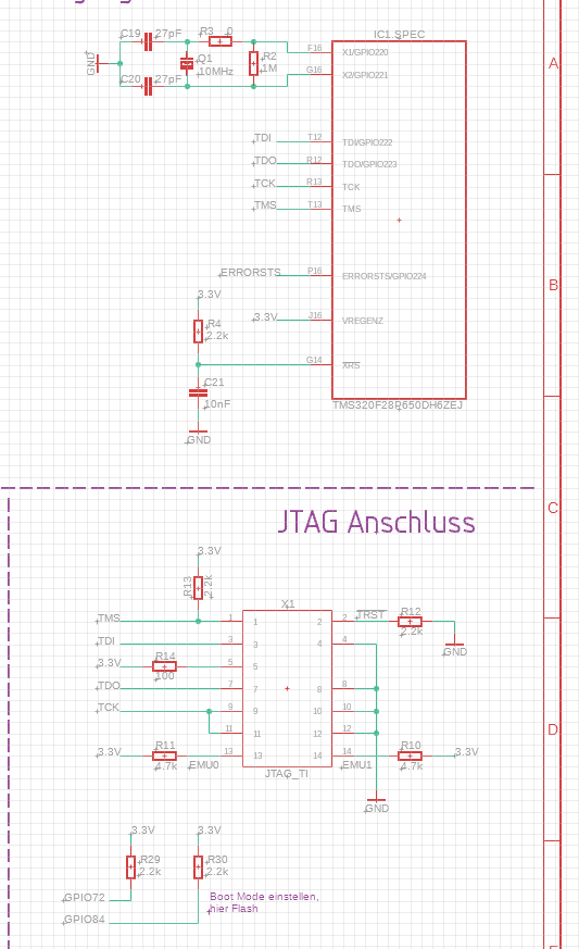

After that the DSP must be powered off an on to work again. I have connected the XDS110 as follows.

    The !XRS pin is connected to 3.3 V via a 2.2kΩ resistor and to ground via a 10nF capacitor.

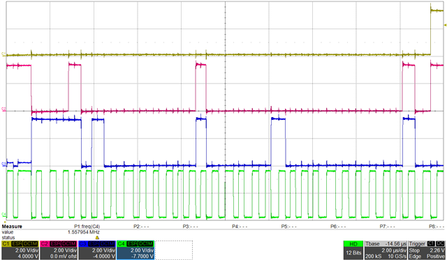

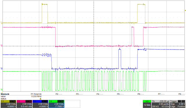

    In order to check the physical voltage levels and the shapes of the JTAG I have measured TMS, TDI, TDO and TCK with a scope
    C1: TMS
    C2: TDI
    C3: TDO
    C4: TCK
    Plot1 shows the operation with 5.5MHz , plot2 with 2MHz TCK frequency. Those plots seems to be ok.

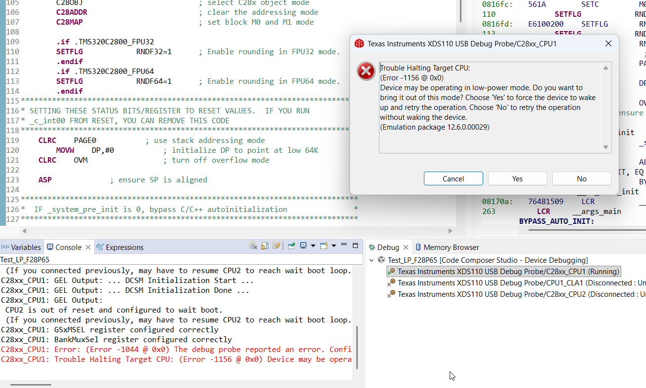

    to rule out the docking station and the USB hub as potential sources of error, I connected the XDS110 directly to the notebook. After about 10 minutes, the debugger disconnected again (see screenshot).
    What is the meaning of the error code 1156?
    A description of the error code can be found here: https://software-dl.ti.com/ccs/esd/documents/ccs_debugging_jtag_connectivity_issues.html#low-power-run-mode
    Are you able to scope the JTAG signals when it crashes? And is VDDIO/VDD stable when this happens? If everything looks okay, then something in your application flow is disconnecting the JTAG probe at that time. Are the mux options for the GPIOs used by TDI/TDO maintained for JTAG usage?

    What´s about the TRST pin at the debugger. On my pcb I have used a 2.2kohm pull down resistor. In contrast to the F28379D the F28P65 does not have a TRST pin. When the debugger is connected I have measured a strange level of 2.6V. Since TRST is a digital pin I expect a level of 0V or 3.3V.
    Could this be a problem?
    Thank you
    Ralf
  • Hi Ralf,
    This could be a potential issue. Generally, we recommend leaving it as NC for our new generation devices that don't require TRSTn. Otherwise, your schematic matches the datasheet recommendations (besides having pull-ups on TDI/TDO). It may also be worth debugging with 2-pin cJTAG to rule out TDI/TDO issues.
