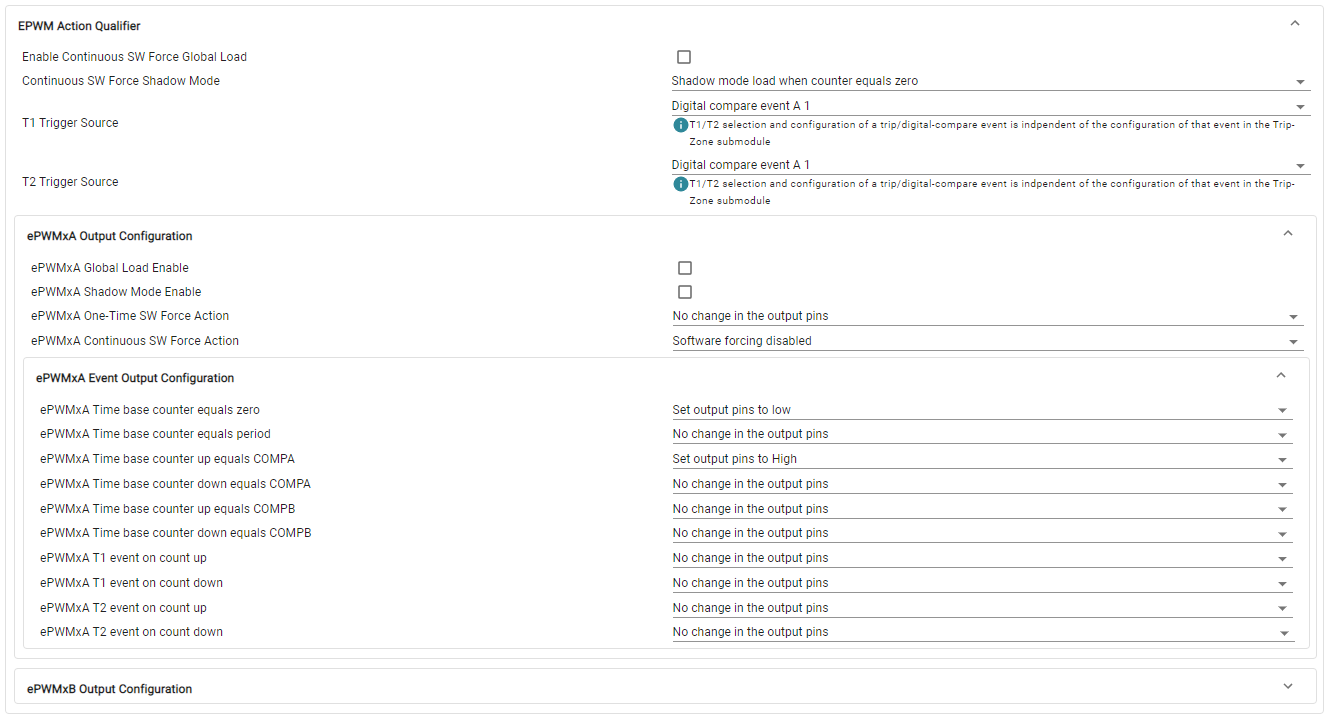

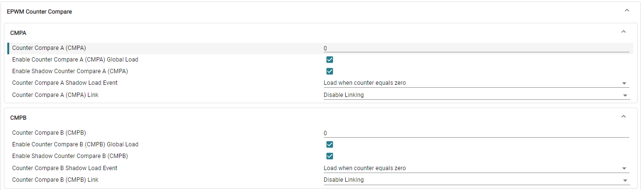

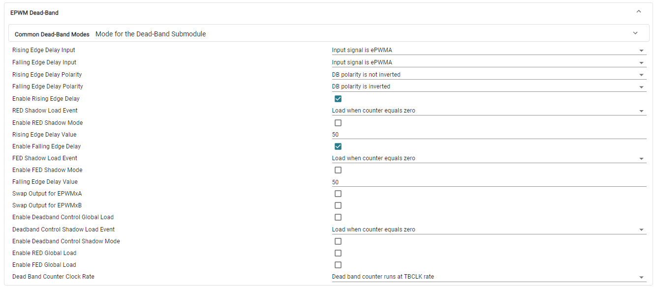

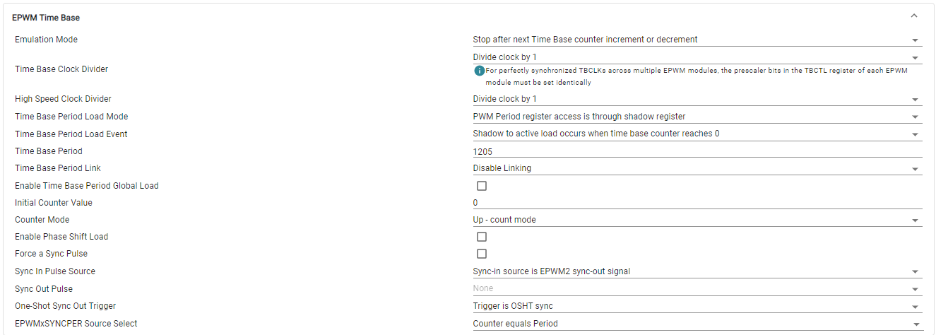

I have a F2800137 C2000 microcontroller and I am trying to generate four sets of complementary ePWM signals, for a total of eight signals. I am using Sysconfig to configure these ePWMs. For some reason, when I run my program from flash, one and sometimes two ePWM signals (not complementary -- usually it's only one of the signals in a complementary pair) doesn't come out. But, when I run it from RAM, all of the PWMs come out.
I thought originally that somehow the deadband module wasn't setting some registers correctly, but since I am choosing both the outputs to be based off of the same ePWM signal, I don't see how one of the ePWMs in the complementary pair can come out, but not the other.
I also thought it might be because I have an ADC ISR to read values from an ADC which triggers every 5 cycles, and that it might be taking too long. But I commented out the entire ISR, and it still gives this behavior.
My ePWMs have a frequency of 100 kHz. I've screenshotted some relevant Sysconfig settings and code below:

    // set EPWM A counter compare value
    EPWM_setCounterCompareValue(epwm_module, EPWM_COUNTER_COMPARE_A, desired_duty);
    // set to low at zero, high at counter compare
    EPWM_setActionQualifierAction(epwm_module, EPWM_AQ_OUTPUT_A, EPWM_AQ_OUTPUT_HIGH, EPWM_AQ_OUTPUT_ON_TIMEBASE_ZERO);
    EPWM_setActionQualifierAction(epwm_module, EPWM_AQ_OUTPUT_A, EPWM_AQ_OUTPUT_LOW, EPWM_AQ_OUTPUT_ON_TIMEBASE_UP_CMPA);
    EPWM_setActionQualifierAction(epwm_module, EPWM_AQ_OUTPUT_A, EPWM_AQ_OUTPUT_LOW, EPWM_AQ_OUTPUT_ON_TIMEBASE_PERIOD);

  • Hi Ben,
    Can you cross check if the DBCTL register is set correctly while the code is running. You can do that in debug mode by viewing the register window. Can you also share the screenshot of DBCTL register value while running the code from RAM and FLASH.
    It is also a good idea to compare the initialization register for both the cases to narrow down the issue.
