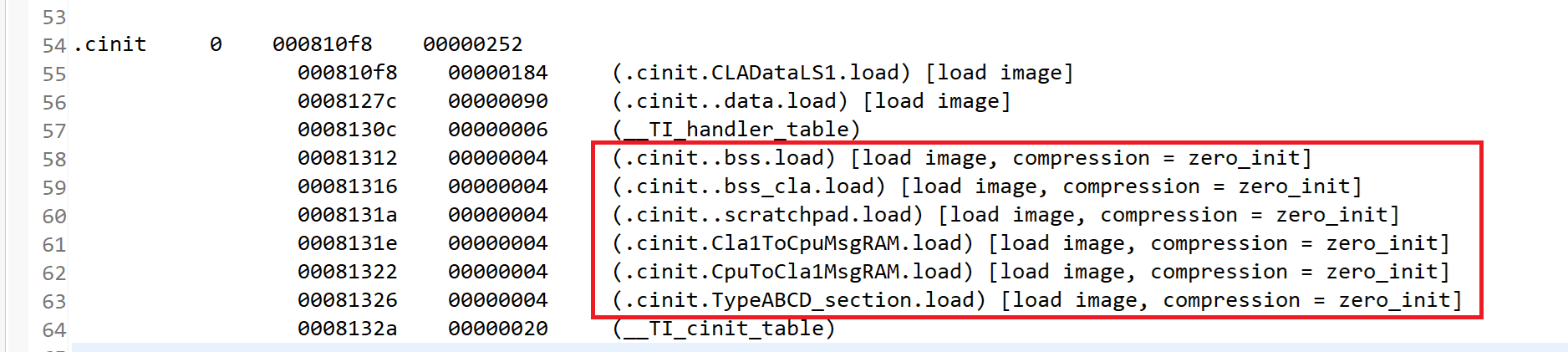

Given EABI output format,
For CLA-defined/declared global/local variables, we are aware that they should be initialized in CLA tasks.
But it seems they are initialized to zero before main from CCS emulation and the .cinit below.
Question:
  1. Would you please confirm the compilers like V22.6.x and V25.11.x initialize CLA global/local variables to zero before main()?
  2. If yes, the user only needs to initialize them to non-zero values. Is it correct?
