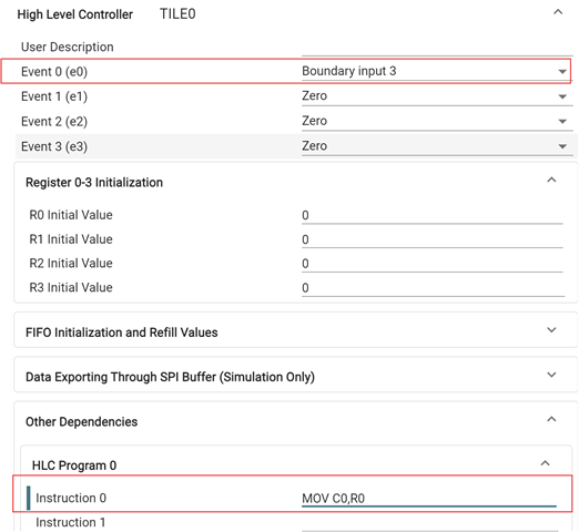

  • Hi Mingi Park,
    As you can see from above, I have enabled four inputs.
    I have selected an ePWM outputs as inputs to CLB Tile. Each input I have selected Rising edge, Falling edge for both channels, ePWM1A and ePWM1B.
    For Time period measurement, I have enabled the counter always. It will always count, because I have given Counter Enable 1. But the counter resets to zero when Input 3 pulse is received. Here Input 3 is the falling edge of EPWM1B.
    In HLC, when Input 3 pulse comes, the counter zero value will be loaded to register R0, which can be accessed by the software.
    From this accessed value, time period can be calculated.
    Similarly, you can find duty, phase shift between two pulses by appropriately configuring the CLB counters, Finite State Machines, High Level counters etc.
    I hope this helps you and enables you to do a lot of things with CLB.
