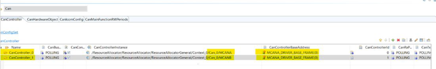

F29H85X-MCAL-SDK: Incorrect CANB Base Address Generation
Part Number: F29H85X-MCAL-SDK
This issue had been uncovered on MCAL 01.03.00 and is still present in the 26.00 package.
The configuration made in Tresos is as follows: CANController_0 → MCANA, CANController_1 → MCANB

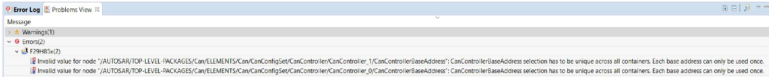

This translated to the same base address being used for each controller instance.
CAN configuration:
Generation error:
This issue translates to multiple CAN controllers could not be configured in Tresos. No simple workaround seems possible as a manual edit of the base address is not allowed.
