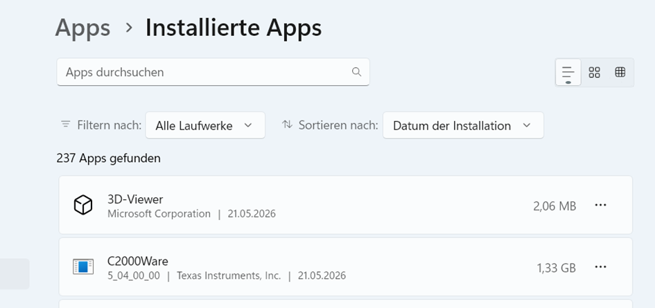

I have copied a complete project (developed with CCS12.6.0.00008) the another notebook. On this machine CCS12.6.0.00008 is also installed. In this project I need some includes from the C2000Ware 5.04. During the first compilation attempt, this c2000ware was not yet installed, so I received an error message. So I have installed the C2000Ware 5.04 on this machine (see screenshots) in the default directory.
Although the correct C2000Ware 5.04 is now installed, I get the same error message. I have restarted the notebook, but this doesn’t help.
Why is the C2000ware 5.04 is not recognized from the CCS12.6?

  • Hello Ralf,
    This is a common issue when moving projects between machines. Even though C2000Ware 5.04 is properly installed, CCS needs to be made aware of the installation. Here are the solutions in order of likelihood:
    Solution 1: Update CCS Product Discovery (Try this first)
    1. In CCS, go to Window → Preferences
    2. Navigate to Code Composer Studio → Products
    3. Click "Rediscover Products" or "Refresh"
    4. CCS should now detect C2000Ware at C:\ti\c2000\C2000Ware_5_04_00_00
    5. Click Apply and OK
    6. Clean and rebuild your project

  • Dear Zackary,
    solution one was already succesful.
    Thank you very much
