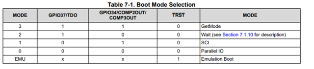

  • Shahajahan,
    This is typically caused by an incorrect/non-existent boot vector in the base project.
    Please take a look at this example in C2000Ware C:\ti\c2000\C2000Ware_26_01_00_00\device_support\f2803x\examples\c28\flash_f28035
    I would compare the .cmd file and main.c against your own.  Also note the inclusion of code_start_branch.asm file that gets called first.  There is also memcopy function call that is required if you have code that is relocated to RAM at run time.
    Another common issue is that the boot pins are not correctly set to enable flash boot; you'll want to make sure these are pulled high for flash boot.
    Finally, for debug purposes, we have an EMUBOOT option, that when the debugger is connected a location in RAM is read vs boot pins to determine boot mode.  There should be a script for this in CCS menu; essentially you would load your code, perform a device Reset via CCS, then Set EMUBOOT for flash and run.  If this fails then it means a standalone boot will not work; and we have to resolve those issues.

  • Shahajahan,
    If you have compared the resources(.cmd file, memcopy usage on main.c, etc) and see no differences then I'm not sure what could be incorrect.  Did you try to load the flash_28035 project and observe if it works as intended in standalone boot mode?
    One other idea would be use use our emulation boot feature to mimic what a flash boot would look like if the emulator is not connected.
    To do this:
    1)Connect to the device with JTAG and launch Code Composer
    2)Load your ,out file via CCS.
    2a)Set a breakpoint near the beginning of you code
    3)Under the "Run" tab in the toolbar select Reset ->CPU Reset
    4)Under the "Scripts: tab go to Emu Boot Mode Select ->EMUFLASHBOOT
    5)Then run the device(play button).
    This will mimic a XRSn based startup, going through the BROM and ultimately your source code.  You should see the CCS hit your breakpoint to know that everything worked correctly.
    If this works, it means that your boot pins are not set correctly per my last post.  If this doesn't work, it likely means that you haven't added the code_start_branch.asm, or placed your code correctly via the linker.
    You can try this with the example I mentioned above, it should work out of the box correctly.
    Matthew
