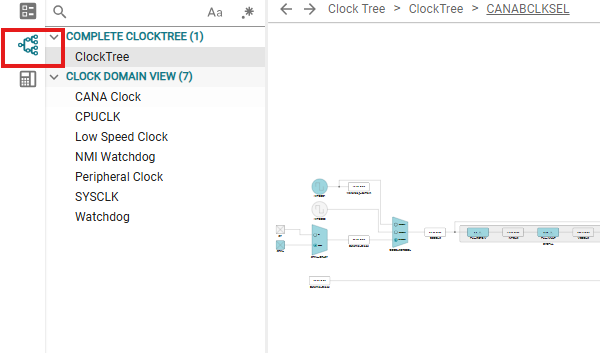

    Clock tree is accessible through Sysconfig as part of GUI.
    Other option to change clocking is in device.h file from driverlib

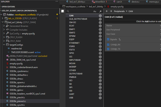

  • Unfortunately, when I open an empty.sysconfig file, my GUI does not have the clock tree button (see below):
    All I get is the peripherals button.
    However, when I do the empty.sysconfig example in the tutorial, I get all three buttons.
  • Hello Kent,
    Please import driverlib project example instead of bitfield. This should resolve your issue.
