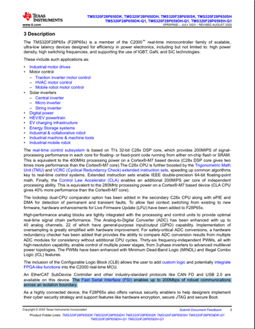

    I want to know where 100 Mbps/200 Mbps shown in datasheet/TRM/documents?
    Best Regards
  • Hi Kita,
    This is shown on the very first page of the datasheet:
    It can be found again here in the description section:
    The throughput values are assumed based on the maximum clock frequency (50MHz) and 2x Dual Data Rate data lines.
    Zackary Fleenor

  • Hi Kita,
    This is assumed based on the terminology "up to" 200Mbps, which means the IP can support Mbps less than 200Mbps, including 100Mbps. 100Mbps could also be achieved by using a 25MHz clock with both D0 and D1. We use this terminology due to the flexibility and variations provided by the SoC/IP.
