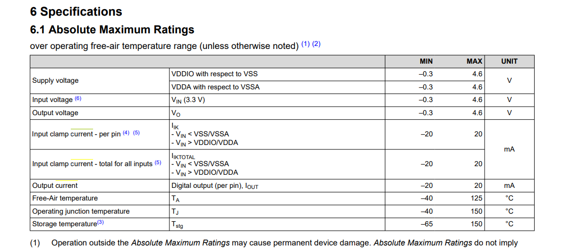

TMS320F28P650SK: Total output current of PWM channel
Part Number: TMS320F28P650SK
Dear Expert,
