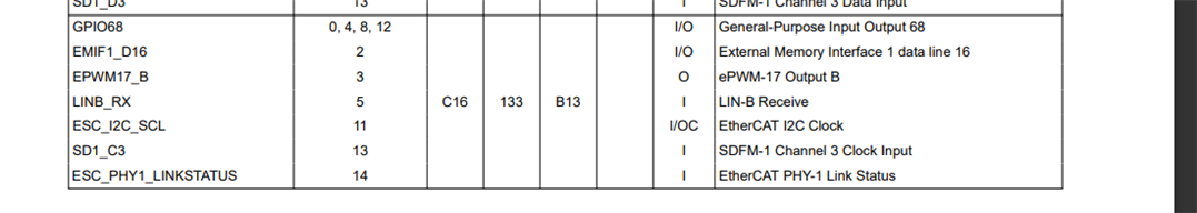

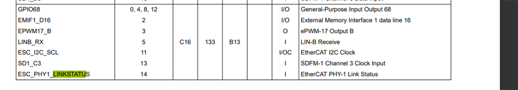

My customer only need to use ESC port0, and want to Port1 GPIO to control other peripheral. But my customer found it they don't configure Port1 GPIO to ESC function. The master can't scan this device.
So it need to be configure port0 and port1 at the same time, even if don't use port1.
