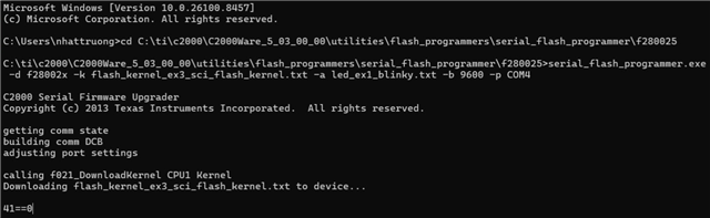

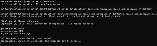

  • Hello Matt,
    Thank you for your feedback. I followed your suggestions. However, options A the cmd is stopped at 41==0 as below
    and in option B, the signal cannot send to cmd as below
    Do you have any other suggestions or other methodS to implement bootloader for MCU2 via MCU1?

    A few clarification questions:
    A failure (41==0) — device type used:
    In your Option A screenshot, the command uses -d f28002x from the f280025 directory. Can you clarify that the MCUs are TMS320F280039C, which is an F28003x device, not F28002x? The F28002x flash kernel is incompatible. Did you re-run Option A using -d f28003x with the f280039C kernel?
    B failure — SCIB initialization:
    When Option B fails entirely (no aa==aa output), the most common cause is that while(!SCI_isSpaceAvailableNonFIFO(SCIB_BASE)) is spinning forever because SCIB TX is never ready. Please verify:
    1. SCIB baud rate on MCU1 is configured to 9600 baud (matching the -b 9600 argument)
    2. GPIO mux for SCIB TX/RX pins is set to SCI function (not GPIO mode)
    3. SCIB mode is non-FIFO (consistent with SCI_isDataAvailableNonFIFO / SCI_isSpaceAvailableNonFIFO API calls)
    4. MCU2 BOOT pins are configured for SCIA boot mode per the F28003x TRM boot mode table
    5. SCI TX/RX physical connections
    To isolate the issue, add a simple GPIO toggle in MCU1's bridge loop so you can confirm with an oscilloscope or LED whether the code is reaching the bridge at all, or whether it's stuck inside the while() wait.
