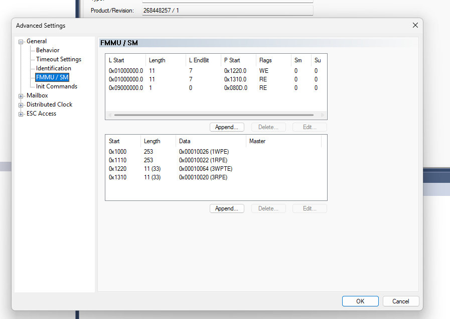

The configuration of our old xml is like follows,
The start address of SM1 is 0x1110 and length is 253. The final byte is odd address. When the length is changed to 252, then the drive can go OP.

    I have run the CPU1_ECHOBACK_SOLUTION on P65 controlboard. The issue is reproduced like follows,
    This means Twincat is unable to read the SDO response.

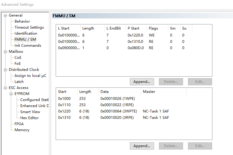

    If I change the SM length to 252, the fault message is changed like follows.
    This is because the following objects are not implemented for writing.

    I think I have noticed the difference. You need to use the XML file I attached, instead of the generated ones. In the example, there is no required SDO download operation for objects like 1C12 and so on.
    You can use any odd length.
    But you can also go to the COE page, all SDO cannot be read.
    But when length is even, then SDO is ok

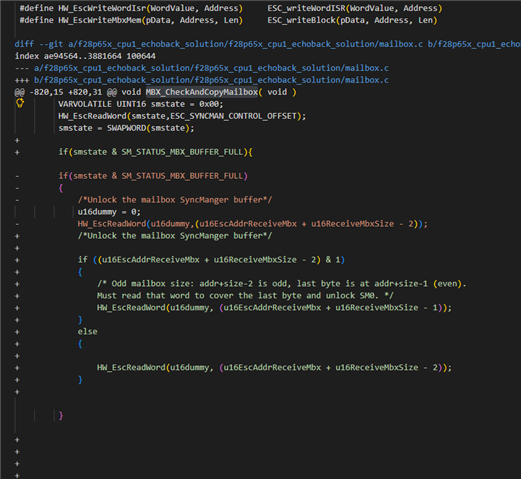

  • Please find the patch attached. Import the cpu echoback  ethercat example along with the stack from c2000ware sdk in ccs workspace . Copy the patch in the workspace folder (Right click your project in ccs and select reveal in file explorer ) and run the command : “patch -p0 < ethercat.patch
    The changes consist of handling odd length cases in the mailbox file.

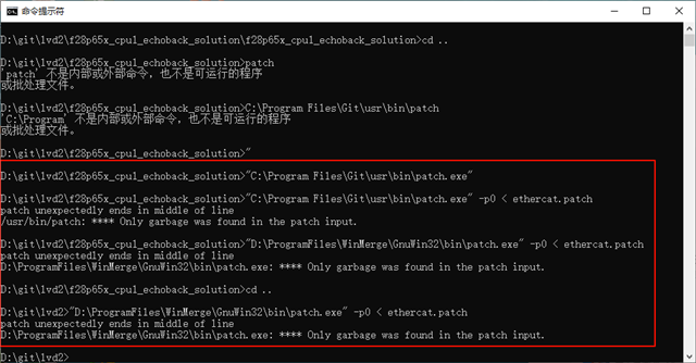

    I tested with patch file with git and GNUWIN32, all returns failure.
    The workspace folder is "D:\git\lvd2", I tested both in and outside the project folder.

  • https://e2e.ti.com/cfs-file/__key/communityserver-discussions-components-files/171/ethercat_5F00_odd.patch
    Can you please check and let me know if this is working . Run "git apply ethercat_odd.patch"
  • Also make sure you are on 6.00.01.00  c2000ware sdk.
  • If you have a different version of ssc tool , you will need to do the changes manually then . There are not a lot of changes can you please refer the patch for the changes to make.

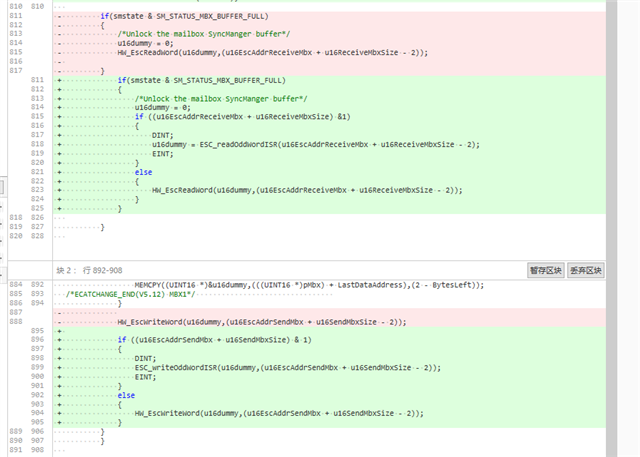

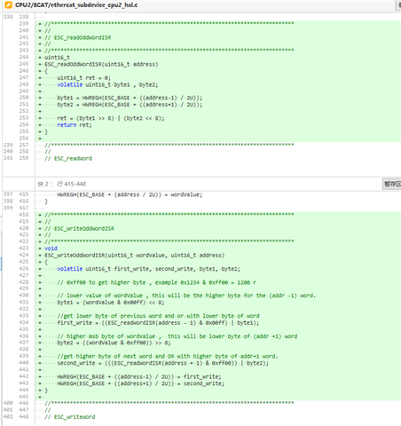

  • Hi Kunal,
    We have identified the issue. We also need a function called readOddByte like writeOddByte.
    There were 2 issue, one for odd length of SM0 and another for odd length of SM1. We were only able to identify the second one.
    The code seems work on any version of SDK.

  • I changed the code in SSC V5.12. C2000 SDK 5.05
    My fix is less general that only dummy byte is considered, as COE messages are way less than 253 bytes. The key is both MBX_CheckAndCopyMailbox and MBX_CopyToSendMailbox would both suffer from odd address.
    In mailbox.c, consider odd address for both dummy read and dummy write.
    In ethercat_subdevice_cpu1_hal.c, add new function readoddword, writeoddword is same as shared.
  • Ok Thanks. ( In my patch I handled it actually , The reason I didnt create a different readodd function is because we just want to read the last byte to trigger. So even if we end up reading more than what is required it should be fine. Will again check with more  experts on this.)
