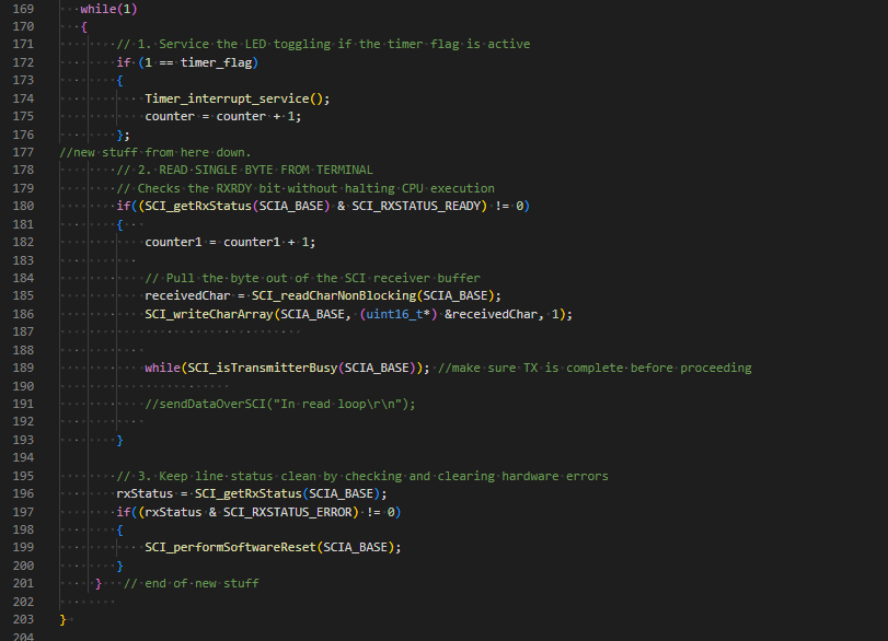

I am bringing up a board with an TMS320F28388D part using an FTDI chip to talk to SCIA (pins GPIO8 and GPIO9).  The following code is supposd to read a character and send it back to to the terminal (9600 baud, 8, N, 1).
When I send a series of a single character (for example 'k'), the return is corrupted about 30% of the time (see below).
I monitored the GPIO9/19 from the TMS320F28388D and noticed that the stop bit is getting dropped leading to the issue.  Otherwise, the signals are clean and have the right timing and amplitude.  It is just the stop-bit that leads to the corruption.
I consulted the forum and was advised to add the following line:
while(SCI_isTransmitterBusy(SCIA_BASE));
However, this did not change the result.  Any other suggestions would be greatly appreciated.

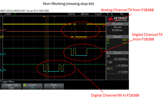

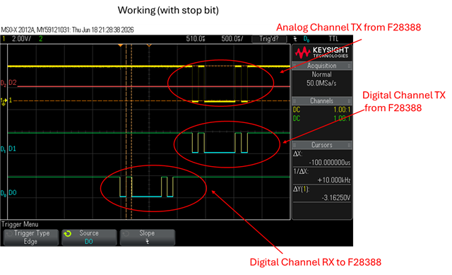

  • Delaney,
    Here is a .bmp of the scope trace for a working 'A':
    The trace D0 is the input (RX) from the PC to the chip on GPIO9, D1 is the output trace (TX) from the chip to the PC on GPIO8.  The yellow trace is an analog channel connected to GPIO8 to look for noise.  Below is a similar trace for when it fails showing the missing stop-bit for a non-working 'A':
    The stop bit is there from the PC in both cases, but in the non-working case, the stop bit is not sent by the chip back to the PC.
    I checked the sysconfig to verify that LSPCLK is 50MHz and it appears to be set correctly.
    Kent

    Here is the InitSCI function for the board.
    void initSCI(void)
        // 1. Enable the SCI peripheral clock (example uses SCIA)
        SysCtl_enablePeripheral(SYSCTL_PERIPH_CLK_SCIA);
        SysCtl_enablePeripheral(SYSCTL_PERIPH_CLK_SCIB);
        SysCtl_enablePeripheral(SYSCTL_PERIPH_CLK_SCIC);
        // 2. Perform a software reset to clear any prior states
        SCI_performSoftwareReset(SCIA_BASE);
        SCI_performSoftwareReset(SCIB_BASE);
        SCI_performSoftwareReset(SCIC_BASE);
        // 3. Configure the SCI module
        // Parameters: Base address, LSPCLK frequency, Baud Rate, Configuration flags
        SCI_setConfig(SCIA_BASE,
                      DEVICE_LSPCLK_FREQ,
                      9600,
                      (SCI_CONFIG_WLEN_8 | SCI_CONFIG_PAR_NONE | SCI_CONFIG_STOP_ONE));
        SCI_setConfig(SCIB_BASE,
                      DEVICE_LSPCLK_FREQ,
                      9600,
        SCI_setConfig(SCIC_BASE,
                      DEVICE_LSPCLK_FREQ,
                      9600,
        // 4. Initialize and clear FIFOs (Optional but recommended)
        SCI_resetChannels(SCIA_BASE);
        SCI_resetRxFIFO(SCIA_BASE);
        SCI_resetTxFIFO(SCIA_BASE);
        SCI_disableFIFO(SCIA_BASE);
        // 5. Enable the module
        SCI_enableModule(SCIA_BASE);
        SCI_enableTxModule(SCIA_BASE);
        SCI_enableRxModule(SCIA_BASE);
        SCI_resetChannels(SCIB_BASE);
        SCI_resetRxFIFO(SCIB_BASE);
        SCI_resetTxFIFO(SCIB_BASE);
        SCI_disableFIFO(SCIB_BASE);
        SCI_enableModule(SCIB_BASE);
        SCI_enableTxModule(SCIB_BASE);
        SCI_enableRxModule(SCIB_BASE);
        SCI_resetChannels(SCIC_BASE);
        SCI_resetRxFIFO(SCIC_BASE);
        SCI_resetTxFIFO(SCIC_BASE);
        SCI_disableFIFO(SCIC_BASE);
        SCI_enableModule(SCIC_BASE);
        SCI_enableTxModule(SCIC_BASE);
        SCI_enableRxModule(SCIC_BASE);
        // 6. Enable Pullups on GPIO8 and GPIO9
        GPIO_setPadConfig( GPIO_PIN_SCIA_RX, GPIO_PIN_TYPE_STD);
        GPIO_setPadConfig( GPIO_PIN_SCIA_TX, GPIO_PIN_TYPE_STD);
        // 6. Enable Pullups on GPIO11 and GPIO109
        GPIO_setPadConfig( GPIO_PIN_SCIB_RX, GPIO_PIN_TYPE_STD);
        GPIO_setPadConfig( GPIO_PIN_SCIB_TX, GPIO_PIN_TYPE_STD);
        // 6. Enable Pullups on GPIO13 and GPIO112
        GPIO_setPadConfig( GPIO_PIN_SCIC_RX, GPIO_PIN_TYPE_STD);
        GPIO_setPadConfig( GPIO_PIN_SCIC_TX, GPIO_PIN_TYPE_STD);
    }//initSCI
    Kent

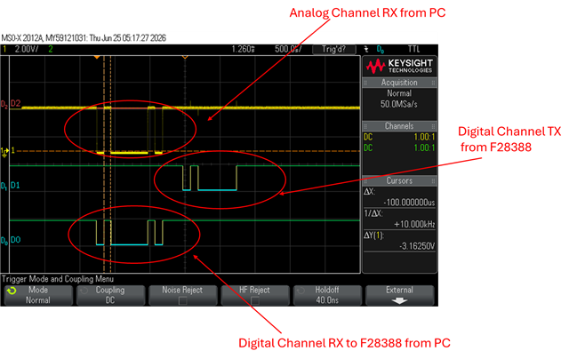

  • Hi Kent,
    Can you place the analog scope on the RX side instead? Based on the register values you showed before, the difference in transmit value makes sense according to what was being read in. The issue should be with the RX signal so I want to determine if there is any noise right at the input of the RX pin of the F2838x.
    Delaney
  • Delaney,
    Here is an analog scope trace of a working 'A' sent to the board:
    Here is the same setup with a non-working 'A'.
    The signals a not noisy from the PC to the F28388.
    Kent
