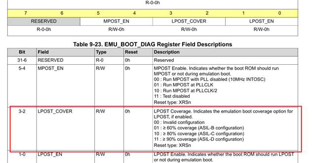

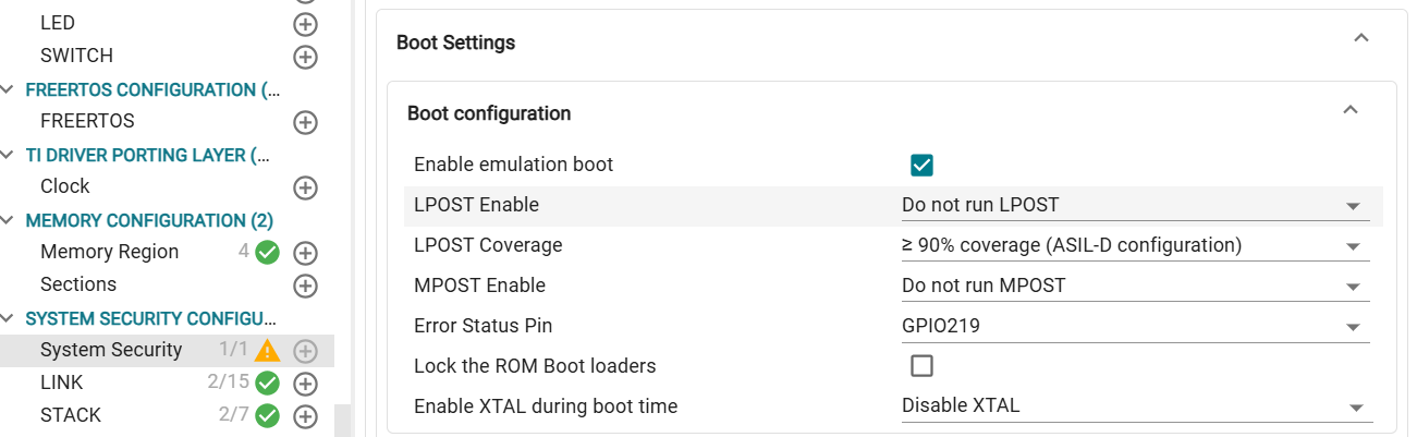

In TRM, it says it should enable LPOST/MPOST in sysconfig

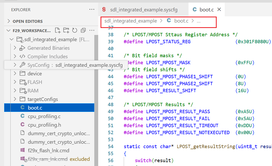

but in our sdl demo in sdk(f29h85x-sdk_26_00_00), the sysconfig can't configure the LPOST/MPOST

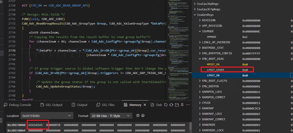

and when we run the demo, the LPOST_COVER is 00, that means the LPOST isn't enable, but the test result is pass, why this is happen?
Do we have more detiled description of LPOST/MPOST related register? I find some description in funtional safety manual
