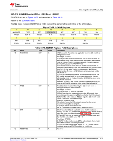

I am looking at spruii0e, pg 3700 I2CMDR.STT. There is a table reference in the Description field which refers to Table 9-6. Should this be Table 33-3 instead?

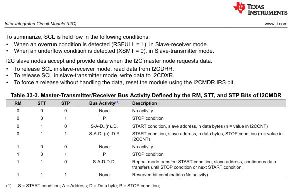

The same issue exists in spruii0f, but the page number is 3727. The reference to Table 9-6 is in the Description field for STT which bit 13 of I2CMDR. I believe that the reference should be to Table 33-3 instead as this table shows the relationships among RM, STT, and STP.

Thank you for the clarification. I have found the issue you mentioned.
I agree with your assessment that the correct reference should be table 33-3.
I will file a ticket to have this documentation reference text issue resolved.
