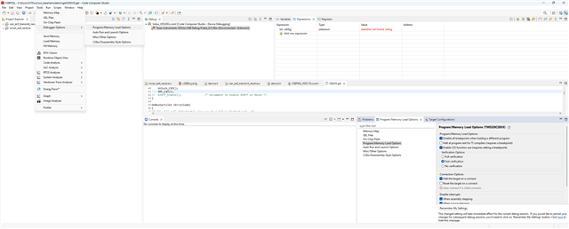

  • Anber,
    I'm theorizing that perhaps the order of operations in the GEL File may not be occurring consistently when you are flashing.  From the error message, I think the positive is that CCS didn't attempt to program the device or was interrupted, causing the flash to get locked.
    I'd like to make sure I understand the CCS settings for connecting/loading, etc   Below is a screenshot showing how to pull this up, I need to know the program/memory load options, as well as the auto-run and launch options.  These, along with the F28335 GEL file will determine what happens when you connect/load.
    Also, when device "fails" have you tried to manually connect to it either in the existing setup or perhaps re-populating it to another PCB, etc?
