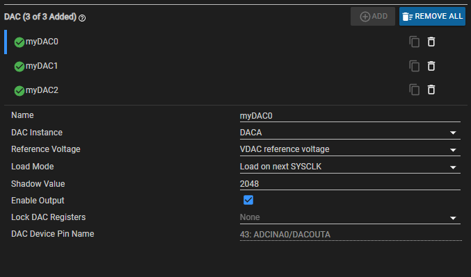

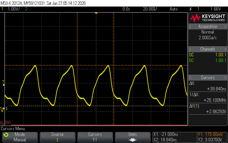

TMS320F28388D: TMS320F28388D Part hangs up on Device_Init()
Part Number: TMS320F28388D
When I set up my clock tree for a 25MHz external oscillator and go into debug mode, the program hangs up on the following code:
#ifdef CPU1
    // Verify the crystal frequency.
    // Note: This check can be removed if you are not using XTAL as the PLL
    // source
    if( ((DEVICE_SETCLOCK_CFG & SYSCTL_OSCSRC_M) == SYSCTL_OSCSRC_XTAL) ||
        ((DEVICE_SETCLOCK_CFG & SYSCTL_OSCSRC_M) == SYSCTL_OSCSRC_XTAL_SE))
        while(!Device_verifyXTAL(DEVICE_OSCSRC_FREQ / 1000000))
            // The actual XTAL frequency does not match DEVICE_OSCSRC_FREQ!!
            // Please check the XTAL frequency used.
            // By default, the Device_init function assumes 25MHz XTAL.
            // If a 20MHz crystal is used, please add a predefined symbol
            // "USE_20MHZ_XTAL" in your CCS project.
            // If a different XTAL is used, please update the DEVICE_SETCLOCK_CFG
            // macro accordingly.
            // Note that the latest F2838x controlCARDs (Rev.B and later) have been
            // updated to use 25MHz XTAL by default. If you have an older 20MHz XTAL
            // controlCARD (E1, E2, or Rev.A), refer to the controlCARD
            // documentation on steps to reconfigure the controlCARD from 20MHz to
            // 25MHz.
            DEVICE_DELAY_US(1000);  // Note: oscillator can take up to
                                    // 10ms to start up per data sheet
 from the device.c file.  I tried to comment out the code butit gets into another endless loop somewhere else in device_init().  My clock is a ASEGT-25.000mHZ-GC with the following waveform:

The DAC is setup in sysconfig as shown:
Any help would be greatly appreciated.

  • Hi Kent,
    From a HW perspective, it looks like the rise/fall times are a bit slower than expected. I would probe the X1 pin directly to make sure the signal is adequate and there is no PCB//routing problem. Ensure the trace length and load capacitance are within spec and check the other pin connections. Issue here could impact the timing.
    To definitively rule out IP configuration related bugs, could you modify the input clock source to use INTOSC2. If there are still issues, then we should look at the SCI and DAC configs. If there no more issues, then we can look at the clock configurations.
    Are you using the SysConfig ClockTree Tool? If not, I would highly recommend doing so as it will greatly simplify the process and remove any accidental additions to your code. Step (1) is to exclude the "device" folder in project file explorer and Step (2) is to select the necessary settings in the SysConfig ClockTree Tool (accessed via the lefthand side icon). I cannot confirm further because you will have to read the actual macros used in the clocktree.h and device.h.
    Aishwarya
  • Aishwarya,
    Thanks for the suggestion.  When I changed the clock tree to INTOSC2, several of my lingering issues went away including instability in the SCIA port.  I have gotten SPI to work now and am working on the DAC.  It looks like the hardware oscillator was the issue and it is probably an result of board layout or parasitic capacitance.  I will have to explore further.  I will keep this thread going until I get the DAC going and may consult with you further on that subject.
    Kent
  • Kent,
    Good to hear!
    Aishwarya
