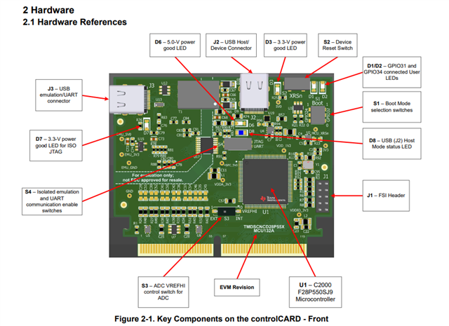

    Are you using the control card? Can you also verify if you have correctly put the ADC VREFHI control switch.
    Additional configurations are not required if you have few channels working. I will check again.
    Harisyam
  • Hi Harisyam,
    I am using the TI LaunchPad evaluation board based on the TMS320F28P55x microcontroller (F28P550SJ9).
    Since ADCB5, ADCB7, and ADCB9 are producing the expected ADC conversion results when a 3.3 V external input is applied, I believe the ADC reference is functioning correctly.
    Could you please clarify the recommended S3 (ADC VREFHI control switch) position for ADC testing on the TMS320F28P55x LaunchPad/Evaluation Board so that I can verify it matches the expected configuration?

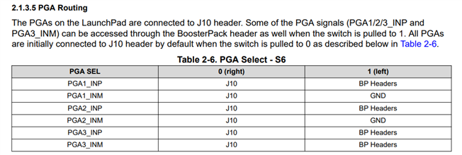

  • Hi Anusha,
    There is a switch S6 in launchpad which makes the connection of microcontroller pin to J10 or the regular booster pack. Can you check if this is connected in the right location.
    The configuration for this is available in launchpad schematic.
    Harisyam

  • Hi Anusha,
    S6 (PGA Select Switch) launchpad needs to be in up position to make the connections to the booster pack.
    C:\ti\c2000\C2000Ware_26_01_00_00\driverlib\f28p55x\examples\adc\adc_ex10_multiple_soc_epwm example code in C2000Ware was tested in launchpad with S^ pin in up position to sample A2 pin and the right results were observed.
    Can you try this example with the S6 switch in up position?
    Harisyam
  • Hi Harisyam,
    After moving S6 to the UP position, the PGA positive input channels (PGAx_P) are now producing the expected ADC conversion results.
    However, I noticed that the corresponding PGA negative input channels do not appear to behave the same way.
    Specifically:
    • PGA1_N (A3)
    • PGA2_N (B12)
    • PGA3_N (B11)
    appear to be grounded or do not respond to an externally applied test voltage in the same manner as the PGAx_P channels.
    Could you please clarify whether this behavior is expected on the LaunchXL-F28P55X board?
    Are these PGAx_N signals tied to ground, terminated, or routed differently on the LaunchPad hardware?
    Also, from a system design perspective, if we design a custom PCB using the same TMS320F28P55x device, will these PGA negative input channels be fully available for user routing and ADC measurement, or is there any device-level limitation associated with these inputs?
     is this a LaunchPad-specific routing implementation, or should the same behavior be expected on a custom board as well?
    Thanks.
  • Hi Anusha,
    This is launchpad specific connection as discussed in section 2.1.3.5 PGA routing of EVM user guide.
    For more details, please refer the following document
    EVM schematic: LAUNCHXL-F28P55X Schematic (Rev. A)
    EVM user guide: https://www.ti.com/lit/ug/sprujc0a/sprujc0a.pdf?ts=1783320533322&ref_url=https%253A%252F%252Fwww.ti.com%252Ftool%252FLAUNCHXL-F28P55X
