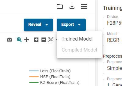

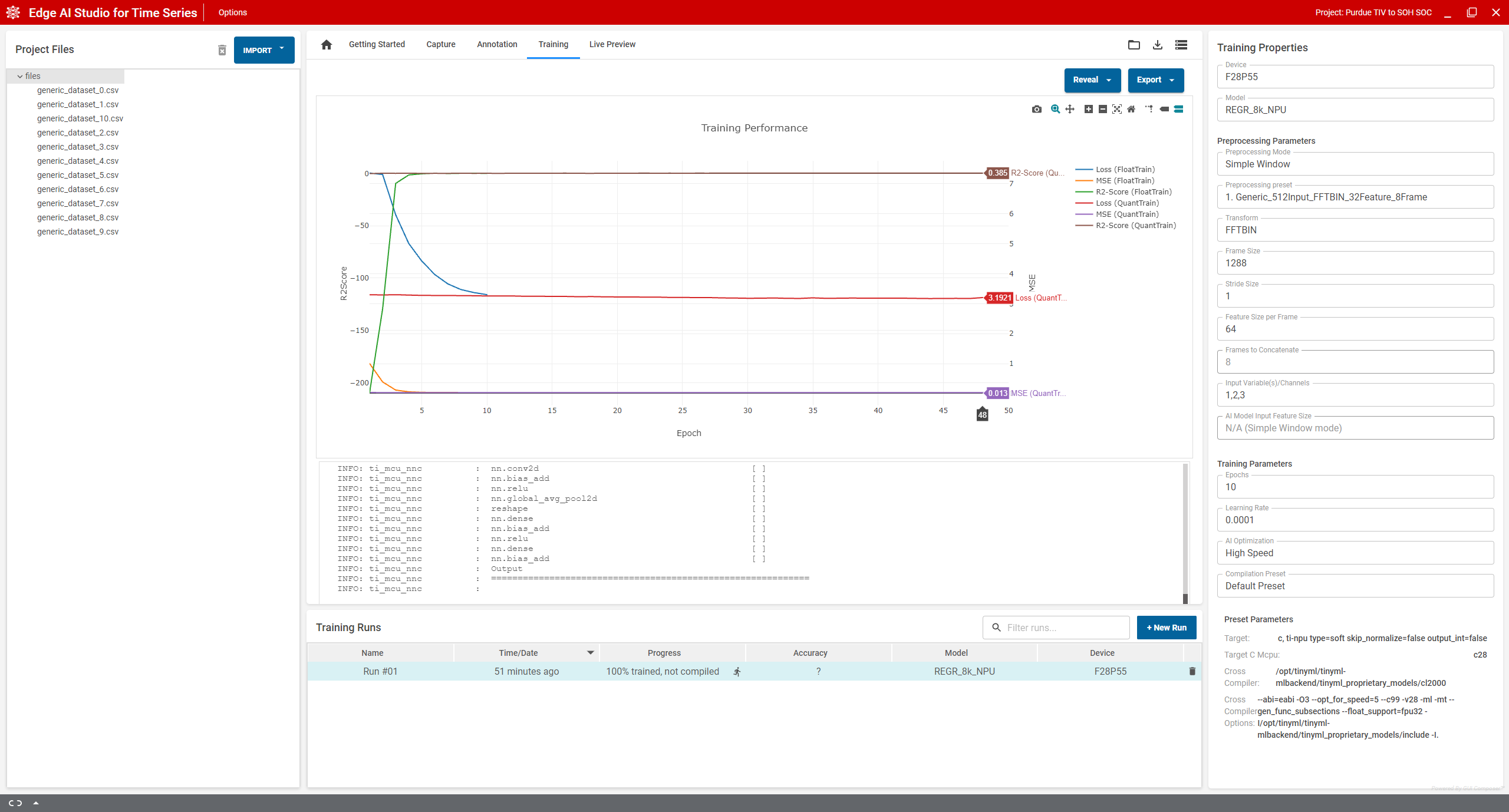

I'm trying to train a neural network to use on the F28P55X, gradually fixing issues as I find them, but the documentation/help files I've been able to find for Edge AI Studio are unbelievably low-detail compared to for example the Resource Explorer in CCS: pretty much all I've found is the Quick Start Guide, which gives hardly any information on what the various options mean or how to troubleshoot the program.
This is as far as I've gotten:
I think I've got everything set up properly to train a model on my dataset to where it will run the model on the F28P55X NPU (again, no specifics are given in the Quick Start Guide). The Export button lets me export a trained model which contains an ONNX, but "Compiled Model" is grayed-out:
I believe I'm supposed to click the little running-man icon here to compile it into something I can use in CCS:
When I do that, I get a progress bar for compilation, but it never gets beyond 1% and then just resets back to "100% trained, not compiled".
What am I missing here?

    Attached the zip of the trained model. The error has occurred in both 1.6.1 (previous images) and in 1.6.0 as per below:
    I'm going to try to run the compilation step with tvmc in the command line next.

  • Thanks for the information.  I can reproduce it with 1.6.0.
    The compile log file shows invalid paths C:\ti\C2000Ware_DigitalPower_SDK_5_06_00_00\driverlib\f28p55x\driverlib and C:\ti\C2000Ware_DigitalPower_SDK_5_06_00_00\device_support\f28p55x\common\include.
    I think our tool should use something like C:\ti\C2000Ware_6_00_01_00\driverlib\f28p55x\driverlib and  C:\ti\C2000Ware_6_00_01_00\device_support\f28p55x\common\include
    I filed a bug to our tool. To workaround the issue for the moment, can you please backup C:\ti\eaistudio1.6.0-timeseries\model-composer-extensions\tinyml-backend-1.3.0\overrides.json, and replace it with the attached overrides.json. The main change is to fix the correct environment variables that are used by our tool to locate the correct C2000Ware sdk.  Please also ensure your installed c2000Ware sdk has the folders listed above.
