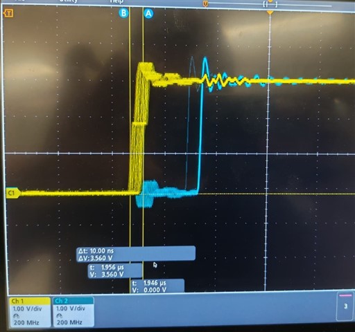

I am trying to synchronize my pwm signal with a unipolar square wave of 5 MHz, fed to GPIO as EXTSYNC1.  In oscilloscope, when I view both the square wave and my pwm, I see that my pwm sometimes jitters by 10 ns, which is equal to 1 tick of the epwm counter.
My ultimate goal is to make the pwm high as soon as the trigger happens, with zero delay. Right now, I have set TBPHS to a certain value, and I can adjust this value to align the pwm with the external trigger and compensate the delay. Could you please suggest how I should resolve this jitterring issue? Or, if there is a better way to go about this?
