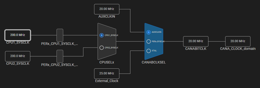

I am facing an issue on SysConfig with configuring CAN peripheral of F28P65 MCU at 500khz with clock source set to AUXCLK.
I'm testing on an F28P65 LaunchPad, supplying AUXCLK of 20MHz with a function generator, and observing the CAN bus with a bus analyzer.
Running the 'can_ex1_loopback' example from the SDK works well and frames are being received correctly on the bus analyzer.
However, when I change the clock source from Peripheral SYSCLK to AUXCLK in the clock tree of sysconfig, the bitrate (as observed on an oscilloscope) is not 500khz.
Changing the value of SysConfig>CAN>'Bit Rate Parameters'>'Device SYSCLK MHz' to 20 (to match AUXCLK) yields 250khz CAN bit clk (as observed on oscilloscope).
Setting this parameter to 10 yields 500khz CAN bit clk. However, the bus analyzer is not receiving the frames likely due to differences in sampling point.
Furthermore, I observed that changing the value of AUXCLK in clocktree does not change anything in the generatde code!
Please help me configure CAN at 500kHz bitrate with clock source set to AUXCLK.

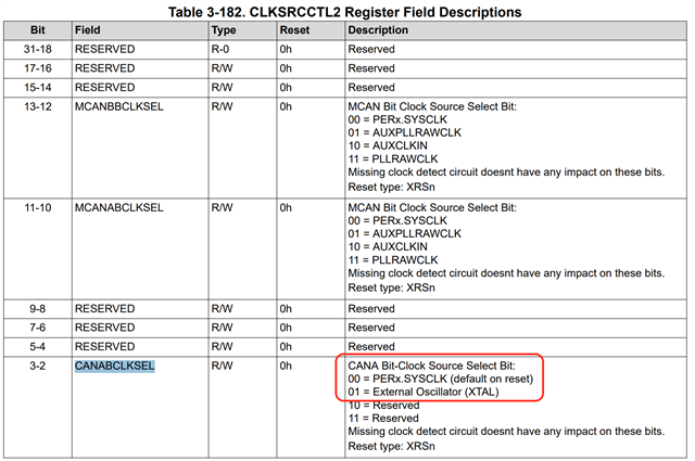

  • Hi team,
    In the TRM, I don't see an option for selecting AUXCLK as a clock source in the CANABCLKSEL register, however, it is available in the clock tree of SysConfig -
    Is this an error in the TRM or SysConfig?

    I observed that the sysconfig generated board.c does not have any code related to the clock source, which is weird. I'll check on this.
    Meanwhile as a workaround, you can override sysconfig generated and manually initialize the CAN module so you aren't blocked by this
    For example it can look something like this, please check the driverlib APIs correctly in C:\ti\c2000\C2000Ware_26_01_00_00\driverlib\f28p65x\driverlib\can.c and C:\ti\c2000\C2000Ware_26_01_00_00\driverlib\f28p65x\driverlib\can.h

  • Hi Ira,
    I was able to get CAN up and running at 500khz with AUXCLK with this initialization -

    Apart from the code generation issue of clock source, please answer these -
    1. What is the functionality of SysConfig>CAN>'Bit Rate Parameters'>'Device SYSCLK MHz'? What value is to be added in this field when clock is not derived from CPU SYSCLK (PERx.SYSCLK)?
    2. "In the TRM, I don't see an option for selecting AUXCLK as a clock source in the CANABCLKSEL register, however, it is available in the clock tree of SysConfig" Please confirm if this is an error in TRM.
    Additionally, I noticed that in the CAN examples (C2000Ware > English > Devices > F28P65X > F28P650DK9 > Examples > Driverlib > c28x > can), apart from ex 1 (loopback) and ex 7 (loopback_tx_rx_remote_frame), the other examples have EMPTY SysConfig files (c2000.syscfg) with NO configurations! Please do fix this as well.
    Dhruva
  • Hi Dhruv,
    1. Enter the actual frequency of whatever source you are routing to CAN (e.g., 20 MHz for AUXCLK, 10 MHz for LSPCLK, etc.). Enter the value in MHz.
    2. Im confirming with the team that owns TRM creation/ maintenance. If they confirm, I will file it as a litbug and have it fixed.

  • Hi Dhruva,
    I just checked with the team and looks like this is an error with the TRM. Usually, we get the register list from design and it looks like this was a bug in the registers xls that was fixed but wasn't ever propagated to the TRM. Fields for both MCANABCLKSEL and MCANBBCLKSEL should be identical (MCANABCLKSEL in the TRM is correct).
    We'll fix this when there is a refresh for gen 3 TRMs
    Cheers!
