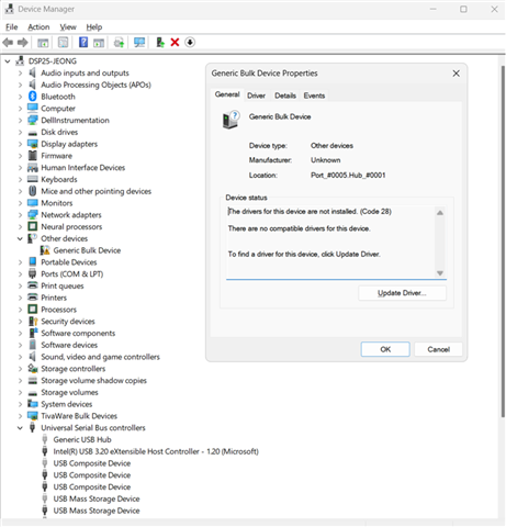

  I am working on developing USB communication through CM core in F28388D. I tested and confirmed the example 'USB Generic Bulk Device (usb_dev_bulk) - CM'. For this example, I have to install the driver 'usb_dev_bulk.inf'. But, I would like to automatically bind to WinUSB.sys without install the driver.
  I tried to use BOS Descriptor and MS OS 2.0 Descriptor as follows but I failed. Let me know if you have any solutions or suggetions.

    Despite this, Windows retries the MS OS 2.0 request repeatedly. Between retries, Windows re‑enumerates the device. Here are additional requests later in the capture:
    [13] MS OS 2.0 Descriptor Set Request — retry #2
    [14] MS OS 2.0 Descriptor Set Request — retry #3
    [20] MS OS 2.0 Descriptor Set Request — retry #4
    [21] MS OS 2.0 Descriptor Set Request — retry #5
    [27] MS OS 2.0 Descriptor Set Request — retry #6
    Between these retries, Windows again issues GET_DESCRIPTOR(Device), SET_ADDRESS, GET_DESCRIPTOR(Configuration), GET_DESCRIPTOR(BOS), etc., indicating repeated attempts to restart enumeration.
    Ultimately, Windows aborts and the SET_CONFIGURATION message is never sent and enumeration is not completed.

  • Hi Siddharth,
      Thank you for your reply.
    I tested your proposal and I wrote the results as follows.
     The proposals:
    1. Pls check if the execution after the BulkRequestHandler enters USBDReadAndDispatchRequest. Since the custom handler has a void return and doesn't halt the driver, execution may be falling into the stack's unhandled fallback route, causing the driver to forcefully run USBDCDStallEP0().
    ==> I confirmed that USBReadAndDispatchRequest was hit after BulkRequestHandler.
    2. Before writing to the EP0 FIFO via USBDCDSendDataEP0, the host expects the device to acknowledge that the control request was valid. Standard descriptors do this implicitly.
    Try adding USBDevEndpointDataAck(USB0_BASE, USB_EP_0, true); before calling USBDCDSendDataEP0.
    ==> I changed the input parameter from ‘false’ to ‘true’ as your proposal.
    Before
    After
    // STEP 1: ACK the SETUP packet
    USBDevEndpointDataAck(USB_BASE, USB_EP_0, false);
    // STEP 2: Send the descriptor data
    USBDCDSendDataEP0(0, (uint8_t *)g_pWCIDDescriptor, usLength);
    // USBDevEndpointDataAck(USB_BASE, USB_EP_0, false);
    USBDevEndpointDataAck(USB_BASE, USB_EP_0, true);
    WinUSB is still not installed as the following.
    I copied USB Viewer results as the following.

  • Hi Siddharth,
      I checked iEP0State. When USBDReadAndDispatchRequest was hit, the iEP0State is eUSBStateIdle.
    Then the execution firstly calls case USB_DTYPE_STRING(= 3) from ‘psUSBRequest->wValue >> 8’ in USBDGetDescriptor then the execution hit USBDGetDescriptor again as followings.
    USB_DTYPE_STRING (first call)  ->  USB_DTYPE_DEVICE(= 1)  ->  USB_DTYPE_DEVICE(= 1)  ->  USB_DTYPE_CONFIGURATION(= 2)  ->  default(= 15)  ->  USB_DTYPE_STRING(= 3)  ->  USB_DTYPE_STRING(= 3)  ->  0x06 (Device Qualifier – high speed only)  ->  USBDCDStallEP0
    FYI, I commented out ‘case 0x0F’ to calls default for BOS in USBDGetDescriptor as followings:
    //Manually stall any impossible descriptor requests. This is a hack to
    //pass certification, which requires a stall in response to a request
    //for a BOS descriptor. For some reason, the driver doesn't do this
    //properly, possibly because of the extra callback handler.
    case 0x06: //Device qualifier -- high speed only
    case 0x07: //Other speed config -- high speed only
    case 0x09: //OTG -- not available on Octave, not supported on others (yet?)
    //case 0x0F: //BOS -- SuperSpeed only  ==> Commented out
    case 0x10: //Device capability -- SuperSpeed only
    case 0x30: //SuperSpeed endpoint companion -- SuperSpeed only
    USBDCDStallEP0(0);
    psUSBControl->pui8EP0Data = 0;
    psUSBControl->ui32EP0DataRemain = 0;
    break;
    The followings are Don's questions:
    In summary, we confirmed that the vendor specific MS OS 2.0 request (VendorCode = 0x01, wIndex = 0x0007, wLength = 0x002E) is successfully received by our firmware and that our handler is being called. We call USBDevEndpointDataAck() and then USBDCDSendDataEP0() with the full descriptor set.
    However, EP0 remains in eUSBStateIdle after our handler runs, and the stack continues into USBDGetDescriptor() and eventually calls USBCDStallEP0(). This suggests that the stack believes the request was not fully handled.
    You mentioned that our handler is declared void, but that is what is expected by the TI stack (otherwise we'd get a compiler error).
    Since the handler is declared void, we cannot return a status value. Could you please clarify:
    1. What specific EP0 state transitions or internal flags must be set for the TI USB stack to consider the vendor specific request fully handled?
    2. Is there an additional function we must call after USBDCDSendDataEP0() to indicate that the DATA phase has begun?
    3. What conditions cause the stack to continue into fallback descriptor parsing after a vendor specific handler runs?
    Jeong
