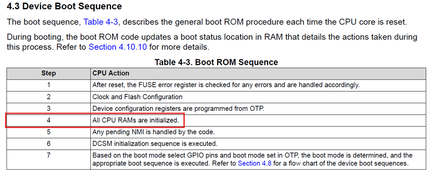

The user needs to have RAM retention function after warm reset including watchdog reset and external nXRS pull low.
We are aware of this RAM initialization on boot-ROM.
Is there any workaround to have RAM retention after warm reset including watchdog reset and external NRST pulled low?
We are thinking of jumping to flash entry on an watchdog ISR to bypass boot-ROM, but it seems it still cannot solve software hang by watchdog reset or external NRST pulled low.
Do you have any suggestion?
