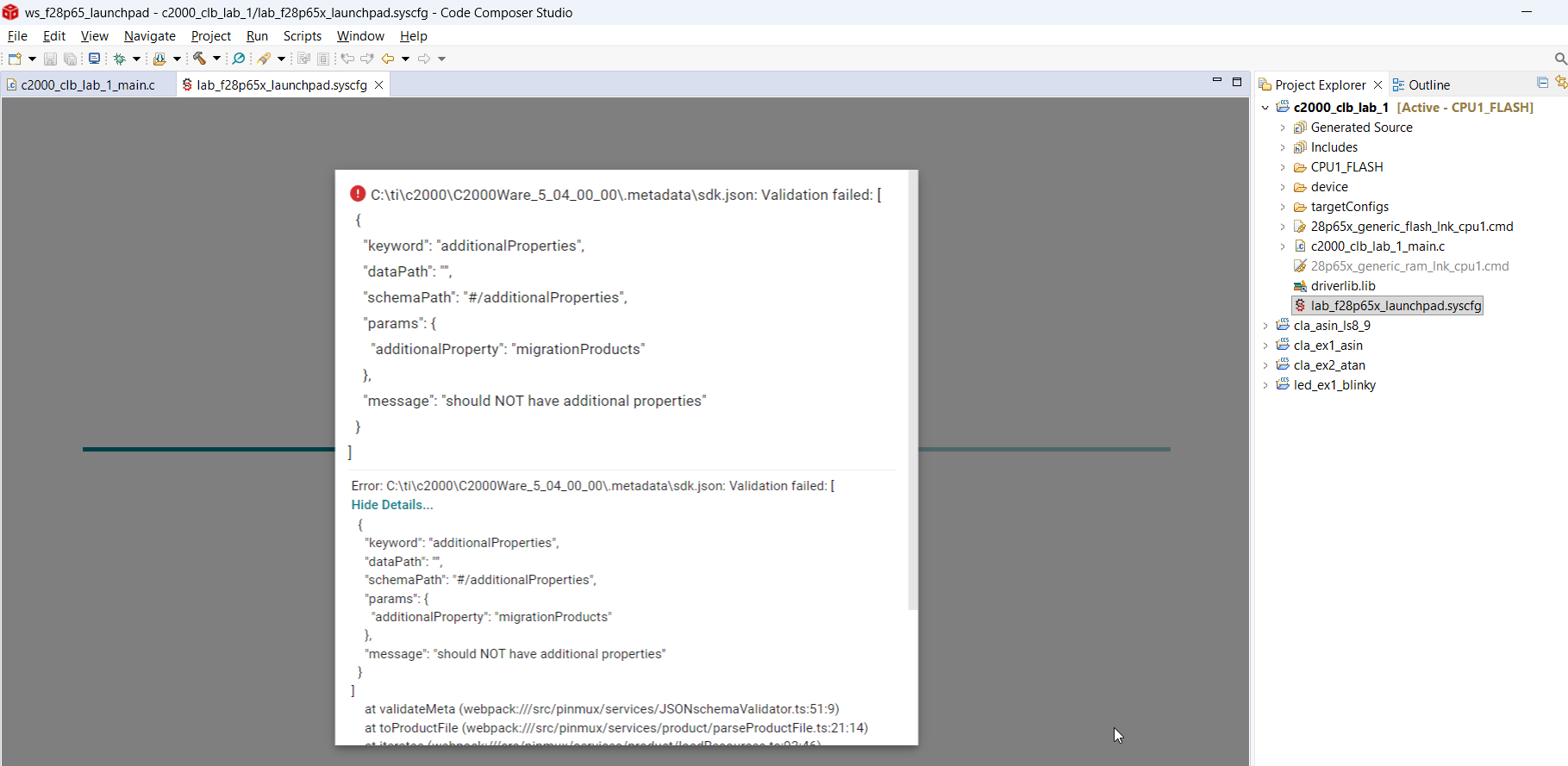

Part Number: TMS320F28P650DH
I want to do the first clb lab exercise from the resource explorer, but I got an error message after starting the *.syscfg File.
How can I prevent this error message?
Thank you
Ralf

Hi Ralf,
can you try importing the project into the CCS once? There has been an issue with resource that is being looked into.
Praneeth
Hi Praneeth,
I have included the clb_ex1 example from the C2000 ware in CCS, but I got the same error message.
I´m new on the clb.
It is possible to configure the clb without the syscfg tool?
Ralf
Hi Praneeth,
I have updated my CCS from 12.6 to 12.8.1. This solves the problem.
Best regards
Ralf
