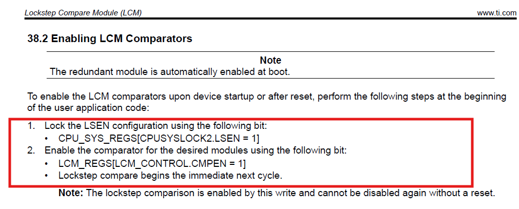

I would like to enable Lockstep module (ofcourse compare enable) on Launchpad F28P65x. I referred Technical reference manual (https://dev.ti.com/tirex/explore/node?isTheia=false&node=A__AMkAGl.8suzL8XPB0e3brQ__c2000ware_devices_package__coGQ502__LATEST) Lockstep Compare Module sectionand followed as per the TRM

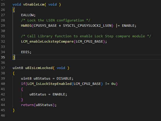

My code implementation is
After calling "vEnableLcm()" function, I called "u8IsLcmLock()" to see whether LCM module enabled or not. Unfortunately, this function returns 0 (not enabled). I am not checking with debug connection. I used printf() to see the status.
Please help me to correct it.
  • I realized that setting LSEN bit is done wrongly. I corrected as below
    /* Lock the LSEN configuration */
        HWREG(CPUSYS_BASE + SYSCTL_O_CPUSYSLOCK2) |= SYSCTL_CPUSYSLOCK2_LSEN;
    And also noticed that the driver library file "lcm.h" contents are suppressed with conditional macro "__TMS320C28XX__" . I tried to define it manually but compilation error throws "this is pre-defined, redefining ignored". i am not able to see where it is defined, if it is defined then why contents of lcm.h are grayed?
    I copied required content from lcm.h to my application as follows, but the issue remains same,
    Please help in resolving this issue.
    PC: I just want to enable the LCM module and see whether it is enabled or not. self-tests are not yet included.
  • Just to confirm, are you running this code from CPU2? I don't think CPU1 has access to these registers. Can you try reading HWREG(CPUSYS_BASE + SYSCTL_O_LSEN) and confirming it returns 1? It should be set by default at reset, but you could double check.
    __TMS320C28XX__ is defined by the compiler automatically. It's basically there in the code to prevent users from trying to call the functions from a non-C28 core (e.g. the functions won't work on the CLA). I suspect CCS is showing them as grayed out because it can't find __TMS320C28XX__ in the code itself. It's unaware that the compiler will define it during the build.

  • Hello Whitney,
    No, I missed this. I am running this enable logic from CPU1. Now I commented this code. didn't do any new code for CPU2 since by default it will be enabled
    I did this one alone in CPU1. still this read operation is returning 0. Later I performed write operation
    Could you please elaborate the steps to enable LCM?
  • It's as it says in the TRM. You just need to run the steps from CPU2.
    • LSEN.Enable = 1 (should already be set by default, but you can set it explicitly if you want)
    • CPUSYSLOCK2.LSEN = 1 (locks the LSEN register to prevent it from being cleared inadvertently)
    • LCM_CONTROL.CMPEN = 1 (enables lockstep compare)
    • Read LCM_STATUS.LSEN if you want confirm it's enabled
    You can use the driverlib functions to do this as follows
    • SysCtl_enableLockStep
    • SysCtl_lockSysConfig
    • LCM_enableLockstepCompare
    • LCM_isLockStepEnabled
    Whitney
