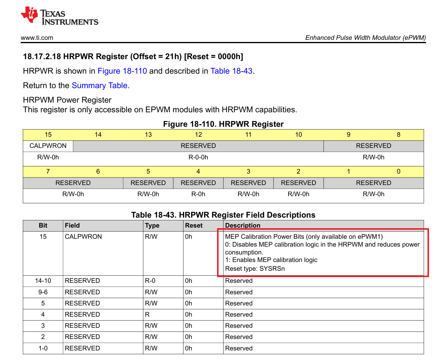

In the TRM SPRUJF8 – MAY 2026, there is
18.17.2.18 HRPWR Register (Offset = 21h) [Reset = 0000h]

  1. Shoud the user enable CALPWRON in the initialization? When should the user use it?
  2. It says it is only available on EPWM1. If the user only uses another EPWM other than EPWM1, say EPWM6, does the user still need to set EPWM1.HRPWR.CALPWRON or the user can just set EPWM6.HRPWR.CALPWRON?

    CALPWRON enables the MEP calibration circuitry. When using TI’s SFO library, a separate manual write is not required, because SFO() manages this register internally. Run SFO during initialization until it returns SFO_COMPLETE, handle SFO_ERROR, and call it periodically during operation to track temperature and voltage changes. Ordinary ePWM operation without HRPWM does not require MEP calibration.
    The calibration circuitry is shared, and CALPWRON is available only through ePWM1. Therefore, the relevant bit is EPwm1Regs.HRPWR.bit.CALPWRON, even when the HRPWM output is generated by ePWM6. Writing EPwm6Regs.HRPWR.CALPWRON does not enable calibration. The SFO calibration result applies to all HRPWM channels.
