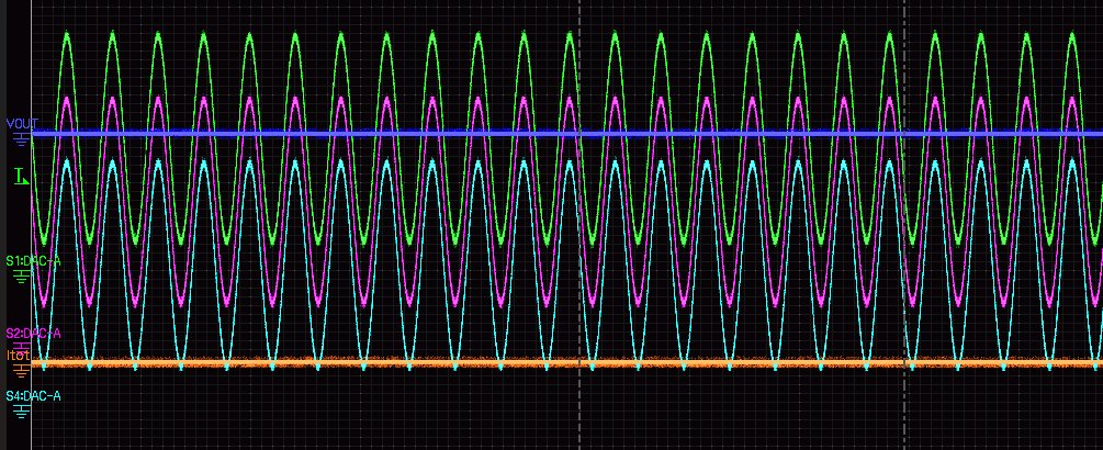

I'm seeing intermittent SCI data when the SCI-D RX pin is left unconnected, even though only SCI-D TX is being used for the data link.

CONFIGURATION 1 - WORKS

CONFIGURATION 2 - INTERMITTENT DATA AT BOARD B SCI-D RX

SYMPTOM
- Configuration 1: data received by Board B is clean. The DAC outputs show continuous signal waveform
- Configuration 2: data received by Board B becomes intermittent

    We do recommend connecting a pull up on the SCI RX pin so that it is logic high when left unconnected to another device. See e2e.ti.com/.../faq-my-c2000-sci-is-not-transmitting-and-or-receiving-data-correctly-how-do-i-fix-this for some more information. Without the pull-up present, flagged RX error conditions are expected when there is noise on the line.
    Generally, RX error flags suggest an issue with the logic in the software. My recommendation is to use these error conditions during the development phase to refine the software rather than expecting these to come up during actual production and recovering. However, yes, the SW reset will technically clear these errors and allow the module to continue receiving future messages. Keep in mind that for a framing error though, the next message will likely immediately trigger the FE condition again if the synchronization with the transmitting device is lost. If you have configurability on the TX side you can have the F2838x send an error message back that halts transmission temporarily to allow for resynchronization.
