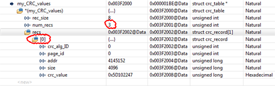

  • Me again...
    is it right that i can't see all entries of my generated crc table in the debugmode?
    I've defined three sections where the linker has to calculate the CRC32 checksum:
    .text        : > FLASHA, PAGE = 0, crc_table(_golden_CRC_values, algorithm=CRC32_PRIME)
    .lut1       : > FLASHB,     PAGE = 0, crc_table(_golden_CRC_values, algorithm=CRC32_PRIME)
    .lut2       : > FLASHB,     PAGE = 0, crc_table(_golden_CRC_values, algorithm=CRC32_PRIME)
     .TI.crctab            : > FLASHC,        PAGE=0
    In the *. map-file are the right three entries:
    LINKER GENERATED CRC TABLES
    _golden_CRC_values @ 003f2000 records: 3, size/record: 8, table size: 26
        .lut1: algorithm=CRC32_PRIME(ID=0), page=0, load addr=003f4000, size=00001000, CRC=5d102247
        .lut2: algorithm=CRC32_PRIME(ID=0), page=0, load addr=003f5000, size=00000200, CRC=36368b8b
        .text: algorithm=CRC32_PRIME(ID=0), page=0, load addr=003f6000, size=00000c9d, CRC=88f1457e
    But if I start the debugger, I can only see one record in the crc_table but num_recs says there are three:
    So I searched for the declaration in the crc_tbl.h and there is only one element of CRC_RECORD in the CRC_TABLE struct!
    Acces at element 1 or 2 at runtime is possible, but...
    Is that right or a bug?
    Ralf
  • Ralf,
    No this is not a bug.  Because of the way the tables are defined only the first entry shows up in the watch window.  If you look at the memory window near the address of the first record, you should see the other two records right after it.
    If we defined the struct to have more than one record, it would potentially take up more space than is actually used in a given application (imagine an application with only one CRC record).  If you modify the struct to match the 3 entries you have in your application they should start to show up in the watch window.  Make sense?

  • Trey,
    yeah it make sense.
    Because the Compiler don't know how many CRC_RECORDS available. First one who knows that is the Linker (F28xx.cmd File).
    But it is a little bit confusing for the first time. A pointer to the CRC_RECORDS would be more clearly.
    If you don't manipulate the Linker it will depend on a double allocation of the same memory because the CRC_RECORDS has only one element.
    Rigth?
