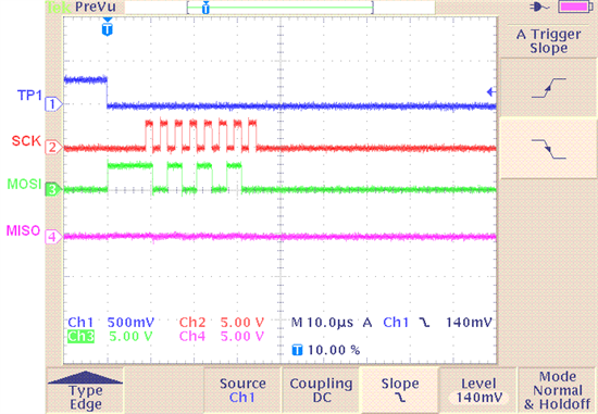

    > 3) Can you check the SPICLK signal with your scope to see if
    >    you see it activate?
    I am attaching the scope trace in response.  At 292.968 kHz
    a single bit ought to last 3.41 usec or about 1/3 of a major
    div on my trace.  The entire screen is 100 usec wide, and
    could display 29 bit times. TP1 is a spare micro output
    which I bring low at the time I would be lowering the slave
    select line, used as the trigger.
    I can't believe this, but you resolved the whole issue! When
    I compare the status of my SPI registers
    after loading the character in the SPITXBUF register:
      SPICCR   = 0x0087
      SPICTL   = 0x000E
      SPISTS   = 0x0040
      SPIBRR   = 0x007F
      SPIRXEMU = 0x0000
      SPIRXBUF = 0x0000
      SPITXBUF = 0xAA00
      SPIDAT   = 0x0000
      SPIFFTX  = 0xA000
      SPIFFRX  = 0x201F
      SPIFFCT  = 0x0000
      SPIPRI   = 0x0010
    the only differences I see are:
      1. The SPI INT FLAG in SPISTS is set.
      2. The SPIDAT register is empty, instead of holding the
         same character as SPITXBUF.
      3. The FIFO registers are not what I was setting them to.
         I assume these are reset values.
    It would appear my understanding of how the FIFO registers
    is insufficient to allow correct configuration. I will have
    to study this.
    Thanks for everything!
