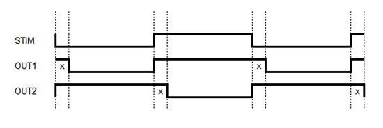

I'm trying to accomplish creating two PWMs triggered by an external stimulus. The signals need to overlap by a software controlled amount of time (x). The picture below shows the signals that I'm trying to generate with respect to the stimulus.
I've been looking at the Piccolo device's PWM module and it is not obvious to me that this can actually be done. Can you please give me some insight on how this can be done if at all.
The stimulus will switch no faster than 500 Hz. I'm looking for the value of x to be on the order of microseconds. I also need to make sure the timing is reliable cycle to cycle.

    Can you elaborate more on how the PWM outputs reflect the stimulus?  For example, is OUT1 ALWAYS high (except for the period x after the transition) while the stimulus is high?  Is OUT2 always opposite the stimulus (except for transition periods)?

    I'll take another look at the deadband module. It is also important to note that the frequency of the stimulus can change at any time.
    OUT1 is ALWAYS high while the stimulus is high. When the stimulus transitions high to low after x seconds OUT1 goes low.
    OUT2 is ALWAYS high while the stimulus is low. When the stimulus transitions low to high after x seconds OUT2 goes low.
    The result of adding in the delay is so that the PWMs overlap by x seconds. So I suppose this is the opposite of a deadband.

  • There's a couple ways to do this.  The best solution I have at the moment is to connect your stimulus signal to the eCAP (you could probably use the ADC too, but I'm not as familiar with it).  You can configure the eCAP to interrupt on every changing edge and use this interrupt to force the PWM output to a specified state in the action qualifier by using the AQCSFRC register.  You can then use our usdelay() function to achiever your required delay, and force the other output low using the AQCSFRC register after the delay completes.  This is the easier way to implement but is somewhat manual.
    If you want the more complex route, still use the eCAP interrupt, but now use two PWM modules (i.e. EPwm1A and EPwm2A).  Now each eCAP ISR you use the force register to set each PWM output to the desired state.  This will affect the output from the action qualifier submodule which then sends the signals to the deadband submodule (reference Figure 20 http://www.ti.com/lit/ug/spruge9e/spruge9e.pdf).  Now if you configure the deadband submodule to have the desired falling edge delay on each of these PWM outputs, it will automatically take care of the delay for you whenever the corresponding signal has a falling edge.  This saves you from having to wait on the usdelay() function and doing another force.
    Please let me know if you have any questions.  There will be some small delay between the time of your stimulus and the time the output is seen on the PWMs.  But since you are only using a 500 Hz signal, it should be insignificant.  Does this seem acceptable?
