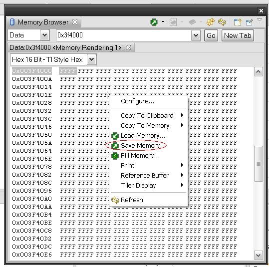

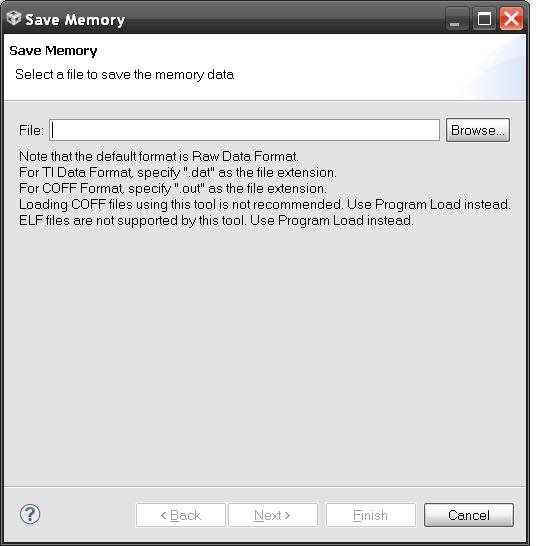

I'm searching the functionality in my CCS 5.1.1 to read back what I have programmed on my DSP and write it to a file?
I'm using the USB2000 Blackhawk JTAG Emulator.
The final goal is to compare my own created bin-File with the flash memory. In CCS3 I used this already but in the new CCS version I can't find this function.
