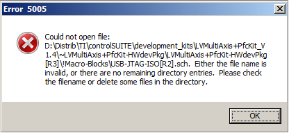

Error opening *.sch file of Dual-Axis kit
Other Parts Discussed in Thread: CONTROLSUITE
When trying to open schematic file from controlSUITE, the following error occurs:
What is the problem?
  • Hi Lucifer...(haha that's so wrong)
    I suspect you haven't installed controlSUITE support for that kit.  Try running the controlSUITE installer and make sure you install support for the LVMultiAxis kit.  If you have done this I suspect the link in controlSUITE is bad.  Try going into the file system with windows explorer and locating the file manually (I suspect the problem might be the "!" in the path).  Remember you'll need the expressPCB software to open the schematic.
    Trey
    Yes, this was the key. Thank You!
