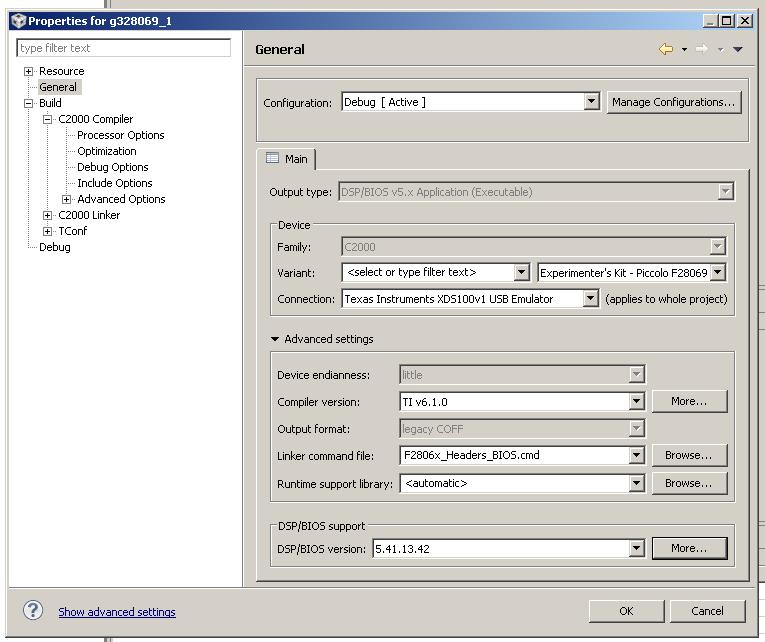

  • Yes,
    I've imported a project, whose name is "g328069_1".
    After some configuration changes, I can now compile, but there is no ".out" file created.
    I get following message:
    "Description    Resource    Path    Location    Type
    This project was created using a version of DSP/BIOS tools that is not currently installed: 5.41.13.42. Please install the DSP/BIOS tools of this version, or migrate the project to one of the supported versions.    g328069_1        g328069_1    Problems"
    Is it possible to make migrate the project to the good version? Or is there an other solution?
  • @Micha��l BOUR
    What version of CCS do you use?
  • I use the version 5.5.
    I have installed the version 6.1 in CCS/CGTools foder. This has created a lot of files, but I haven't got the 6.1 version.
    What shoult I do?
    Best regards
  • @Micha��l BOUR
    This is a poblem of current DSP/BIOS version, not Code Generation Tools (compiler). Try to do migrating to your current DSP/BIOS through this menu (change DSB/BIOS version):
    Igor
  • I have got now this warning:
  • @Micha��l BOUR
