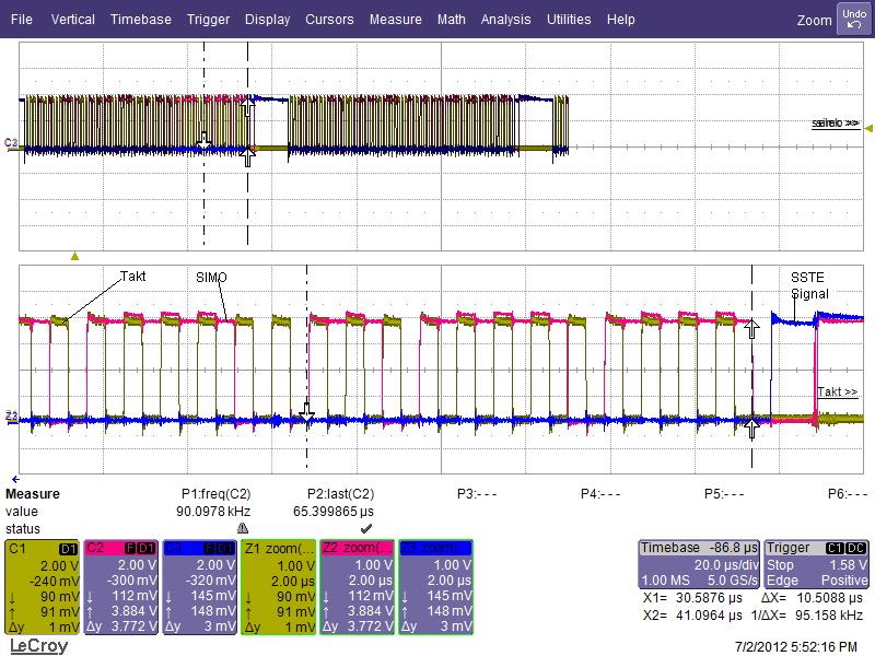

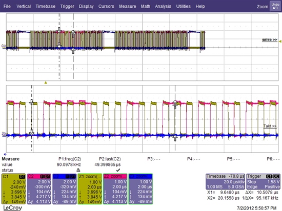

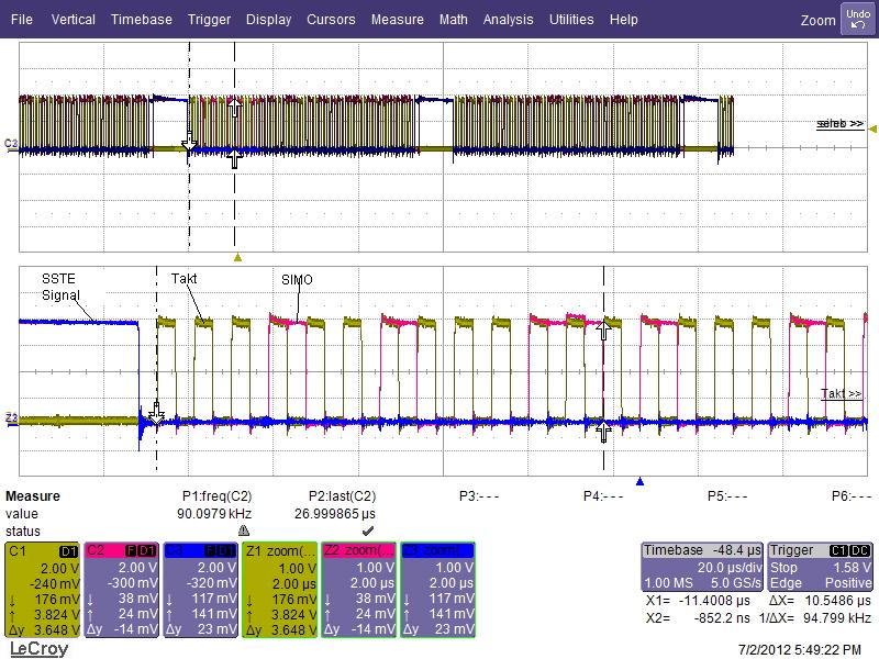

Im using a the SPI  of the TMS320F240 as slave. I use it as slave and i would like to read the bit stream that a external Master sends to the TMS320F240
As a Test Pattern, the external Master sends 0x123456789ABCDEF. This is a bit stream of 60Bits (15 Bytes7.5 Bytes), at 1.14MBitps, After each bit stream there is a small Pause of ca 9microseconds.
The bit stream, looks like this (with zoom for each 12 Bites):
123
456
789
ABC
DEF
Should it be a problem for the SPI TMS320F240  to read this stream, as it is an 8 Bit Peripheral? Is it possible to receive this string? and then with software distribute in 8 Bit Variables?

    There aren't many people who are still familiar with this device as it is very old and is being discontinued.
    I am very familiar with our SPI which followed this one.  Based on that, I would not expect there to be any problems.  My thought is you would just have to read the data after each 8 bits to prevent it from being lost.  However, I do not have any experience with this peripheral.  I would recommend giving it a try as this will probably be faster than waiting on an answer from us.
    Kris
  • Thank you Kris,
    Yes, I've been traying for a while.  The TMS320F240 is part of a development board, which didnt give to much information about it. As the only acces is through funtions developed specifically for this development board and a I got recurrent errors, since im beginner, i just wanted to understand the meaning of "8 Bit Peripheral" and discard the possibility that the error were due to the lenght of the transmision (60 bits much more than 8 Bits). For  a moment i thought there should be a pause every 8 Bits, but as i read your post. I see the master the transmition can be this long (60 bits without pause) and the information will be received as long as it is read every 8 Bits. so the Pause is not necessary and i can focus to search an other causes of the errors.
