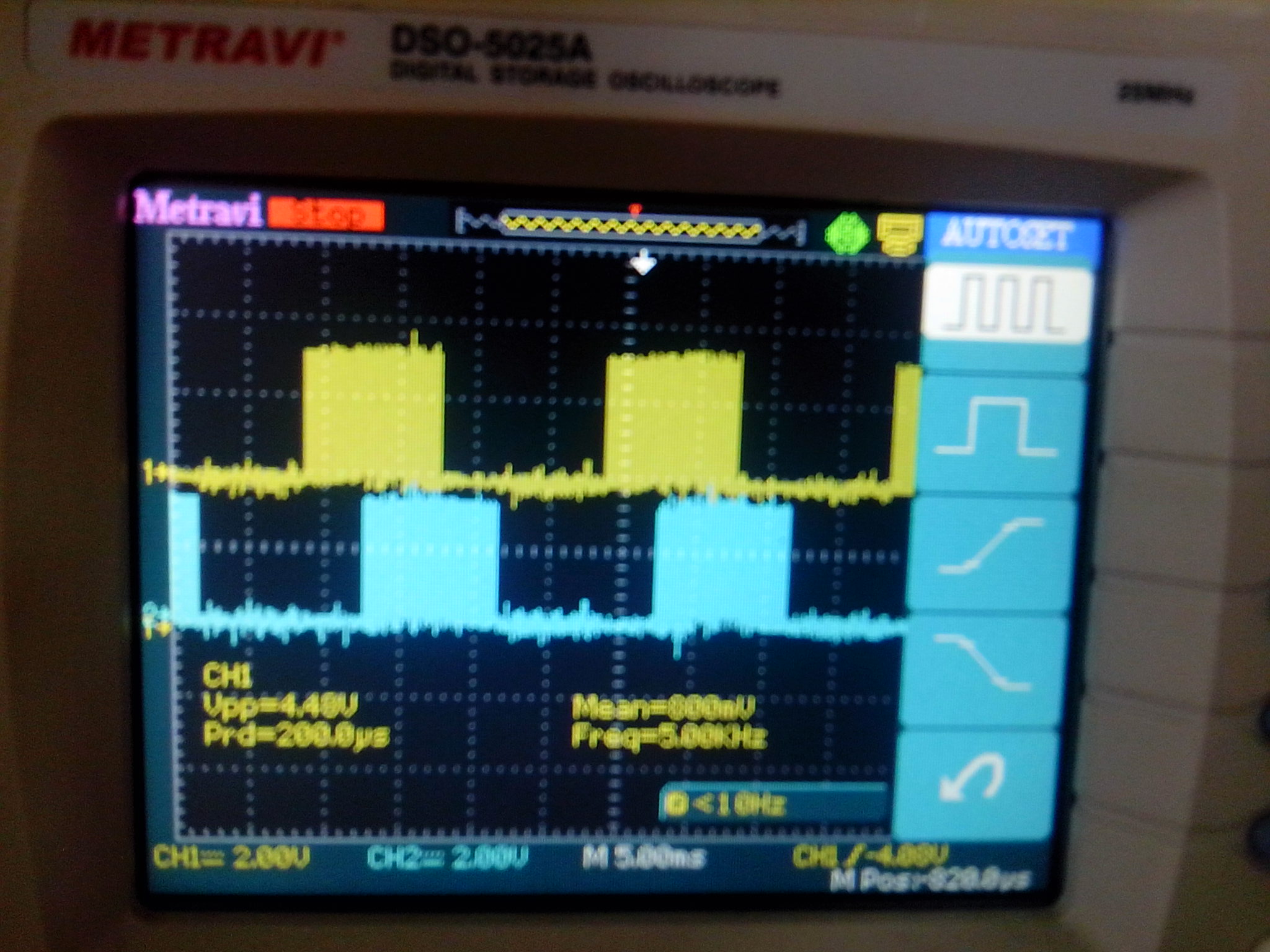

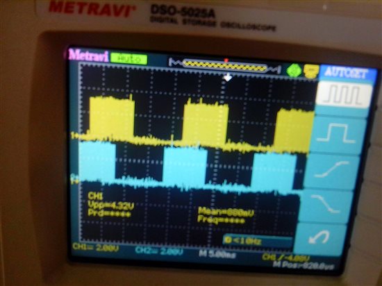

  • hello,
    i m pradeep and i m working on synchronization of epwm on piccolo f28069NPA so my problem in code i m generating ewpm on interrupt isr function so if i m using interrupt isr i m unable to do synchronization properly means to say i can lock master piccolo pluse with slave  piccolo pulse but  i m unable tolock in phase shift both are not starting with zero degree... when i m connecting synco of master with synci of slave then at that insistent both pulses are getting lock but the phase is not same as i mentioned with zero phase in code
    if i remove and reconnect synci and synco then again i m getting new phase shift....
    and as from above discussion i came to know one thing to do synchronization we need to keep SYSCLK/2 right but i m using SYSCLK/1 is it makes any difference in piccolo f28096
    waiting for reply,

  • thanks for reply,
    i m setting 1)tbprd=2964 and cpma=296 so for one clock cycle what is value i need to feed in to phase register...
    2)  said to feed CTR=period means tbprd right
  • Hi radeep kumar ama,
    1) tbphs = 1
    tbctl.PHSEN = 1
    2 ) right
  • hi thanks for reply,
    still im facing the same problem
    this is the setting i m giving for slave piccolo

     i attaching photos also when i m reconnecting the synco t synci then the pulses are locked at different angles not at zero..
