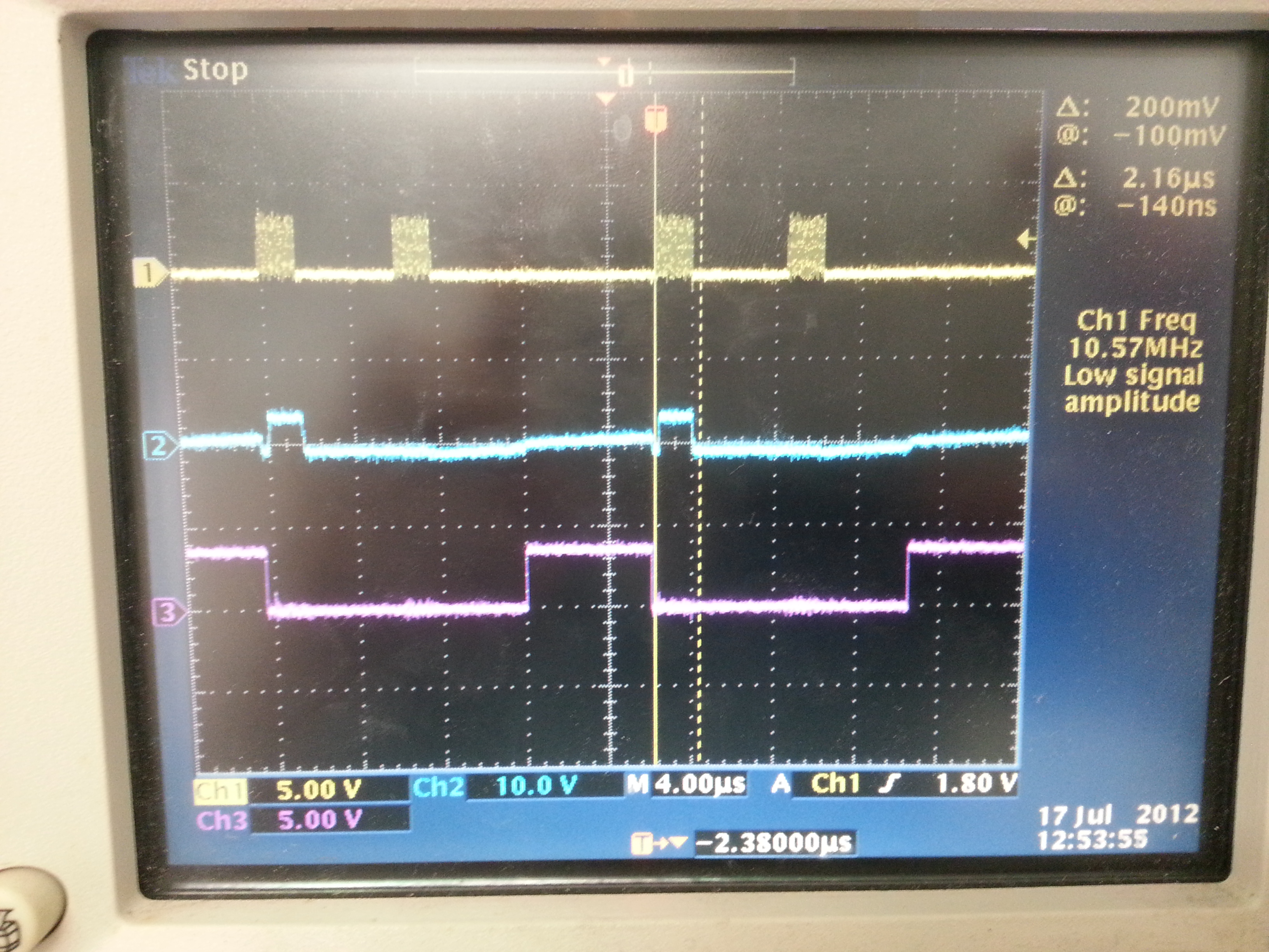

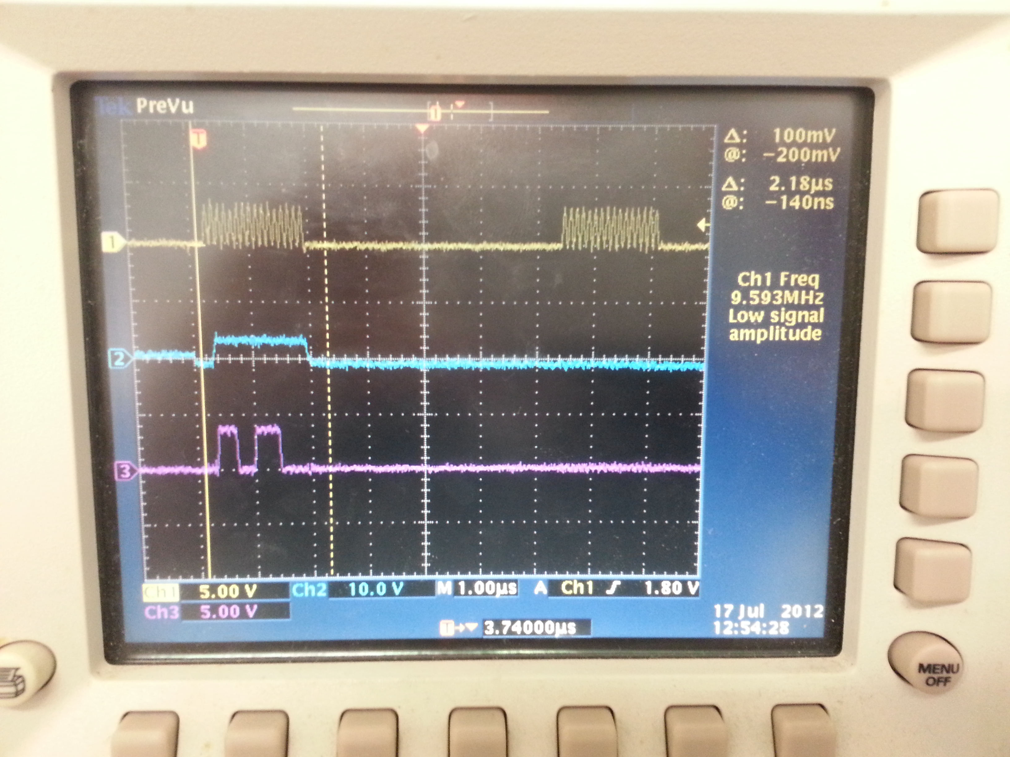

I'm currently having problems communicating via 4-wire SPI between the F28335 and the AD7699. I believe I have the SPI configured correctly on the F28335 by observing the inputs/outputs on a scope. My main two problems are: 1) while trying to configure the SPI clock above a lower freq (above ~5 MHz) it becomes an ugly triangle wave which could or could not be a problem and 2) It looks like I am sending the proper configuration to the ADC on the MOSI but while on the read back configuration setting, the MISO is not properly reading back the configuration or the correct voltage reading output (3.3 VDC). I have attached a scope print out and code below. I used an example program for the SPI setup. Any help is appreciated, thanks in advance.

Yellow = clock,   blue = MISO,   purple = CS (above)  or MOSI (below)
  • Hi Hale,
    1) 5MHz should be no issue for an F28335.  The triangle waveforms you see may be due to a combination of your scope's maximum sampling frequency and the timescale it is set to during capture.  Try going to a smaller timescale and observe the waveform then.
    2) You can try setting the SPI to loopback mode to verify the commands you are sending out to the ADC.  If those commands are correct, perhaps your code is mis-interpreting the data it receives from the ADC.  If you can determine what the raw data the ADC is supposed to send back, you can compare that with the raw data the SPI saves.
    Daniel
  • Daniel,
    Thanks for getting back to me so quickly. As for your first suggestion, I am using a 300MHz scope which should be able to sample quickly enough. For your suggestion on loopback mode, that is what i meant by "read back" in my first post. So, I am sending 0x71E0 and should be receiving that back as well as 3.3 VDC or 0xCE40. As you can see in my scope print outs, the word I'm sending to the ADC is correct, but I am getting back junk.
    My ADC configuration is set up for:
    keep current config, unipolar and inputs referenced to GND, input channel IN0, full BW, external reference and internal buffer, disabled sequencer and to read back current config
  • If you have confirmed the data being sent over SPI using loopback mode, then let's assume the command is being sent to the ADC correctly.  BTW, you are probably doing this, but make sure you disable loopback mode when actually trying to talk to the ADC.
    Assuming the data sent to the ADC is correct, the problem is then in the ADC interpreting the command and responding.  Can you post some shots of the waveforms being sent to the ADC?  I am not familiar with the ADC, but I would first verify the timings and sequencing matches the ADC specs.
    I took a quick look and it said it requires two dummy conversions to perform configuration.  That would be where I would start looking at.
